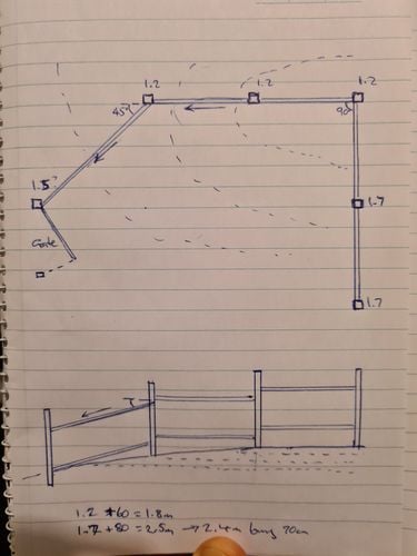

Planning to build a timber picket fence and gate to enclose our front garden. We will have a section that runs part of the dividing boundary with our neighbour, then a right angle, two sections that will run the front boundary which is on a slope so I'll have to step it down, then a final section that will truncate at a 45 degree angle at the opening of our driveway. The last section is also on a slope so I'm going to have to slope this section of the fence.

However, I have a few questions about how to do the stepped, angled and sloped sections.
1) What's the best way to do the cuts for the railings in the corner post where I have the right angle? Do I just have the railings set slightly higher/lower on one side than the other?
2) On the truncated section, I'm going to have to join the railings to the post at 45 degrees to the right angle of the post, and also on a slight slope. Any tips on how best to measure and cut these? Also mindful that however I set the railings on this section need to avoid getting in the way of the railings and pickets on the other side of the post.
Any advice appreciated.
Sketches may help explain all this.
