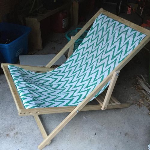

I've made this:
Wood Folding Sling Chair, Deck Chair or Beach Chair - Adult Size | Ana White
I just used timber from Bunnings but I replaced all the bolts with 25mm dowel and 4mm dowel as a locking pin.
We used canvas material from Spotlight which my wife sewed.
For your case, the materials would be common. Most picnic tables are just using framing timber and decking timber which Bunnings has. Much of the wood mentioned in American sites is some form or pine or some hardwood so shouldn't be too difficult to find local versions.
