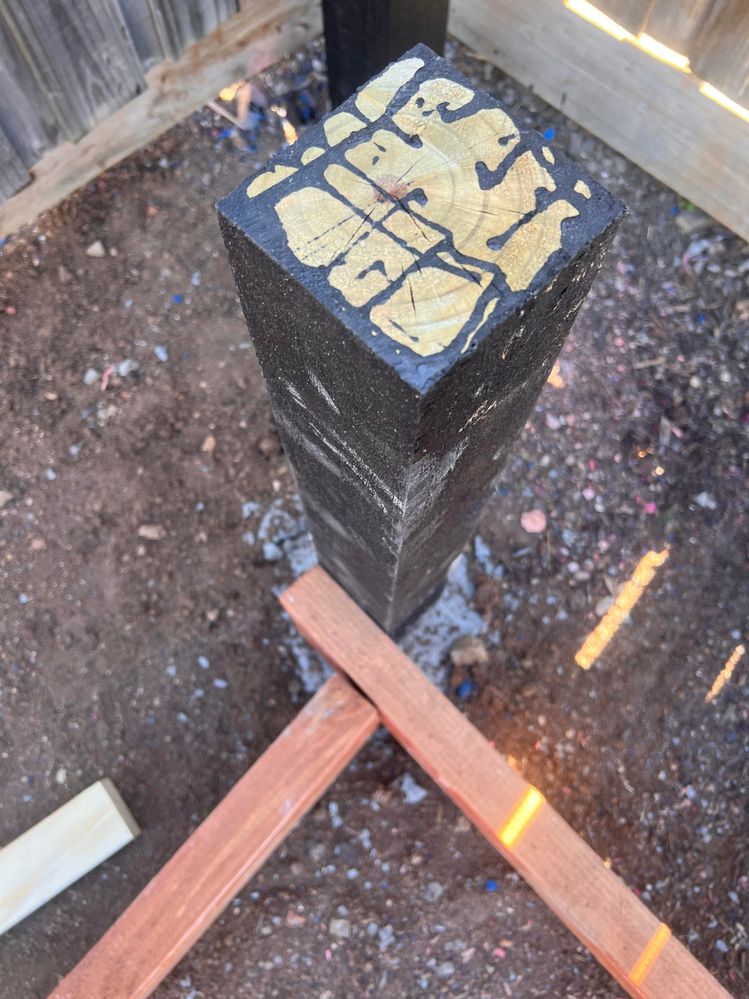

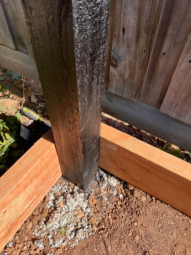

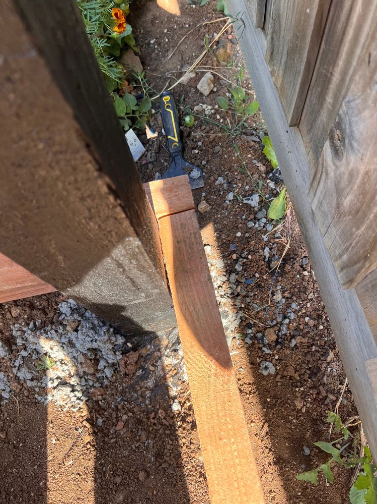

I am trying to fix sleepers to the post inorder to finsih this project. However i am facing hardtime fixing sleeper beside fence to the post. Is there any techniques that you could suggest ?
width of post 100mm
width of sleeper 50mm
Here are couple of things i am thinking
1. I am thinking to fix from inside with 150mm galvanised screw i.e. on post into sleeper
2. Use angular brackets and fix them ( not sure which one to use though ) I am thinking of using https://www.bunnings.com.au/carinya-50-x-50mm-galvanised-angle-bracket-4-pack_p0137857
Appreciate any help on this one , thanks in advance.
In addition to above the other challange i will face is fixing the intersection where two sleepers join to the post. I am running out of ideas for this one as well. Unable to identify the strongest option.
Hello @nvelaga
For good holding power, I suggest going with your idea but using a longer nut and bolt set such as the ZENITH M12 x 170mm Hot Dip Galvanised Cup Head Bolts & Nuts. Make sure to use washers at the end to prevent the nut from eating into the timber. The same can be applied to the other corner of your garden bed. But just to be sure can you please show us the final position of the sleepers so that we can give you proper advice in regards to the bolts to be used.
Thanks @EricL , Bolts will work for posts beside the fence. I am not sure how to use bolts for the corner post where two sleepers intersect.
Do you think i should attach one to post and the other to the sleeper attached to post ?
