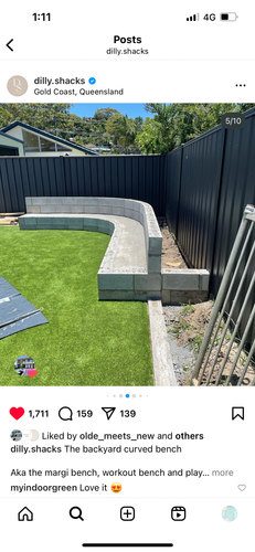

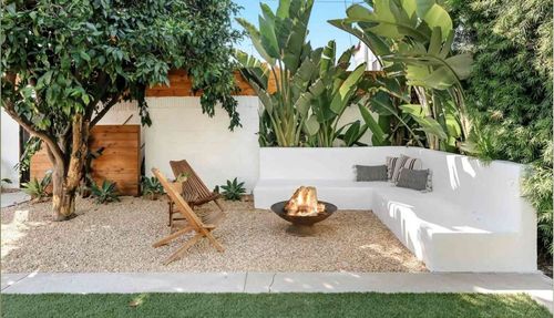

I’m wanting to build a besser block outdoor seat and render it. I’ve been researching and have seen 2 styles. One fills the middle with concrete, but the other uses wood and then cushions. I don’t want to have cushions on it.
im wondering a cheaper alternative to filling the entire inner seat with concrete.
 Could I use a wooden frame and then lay pavers on top and render?
Open to ideas!
