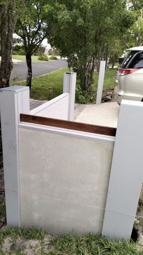

I am wanting to build a sliding gate for my driveway entrance. I have already built the wall and made the pedestrian gate. I thought I will make it a manual gate for now and adding the automatic motor can be the next project. The gate will be 3750 W x 1500 H.
Any suggestions on what to make the gate frame out of? I did want to do it in steel tube like I did for the pedestrian gate. But I made that out of 20 x 20 steel square tubing and I am pretty sure that won't be strong enough for a bigger driveway gate? It would need to be 50 I would think? I did think of the Fortress Gate kits? Can you make one in the size I need for a driveway gate?
I also thought of using Pine, maybe 70 x 35 H3 Structural Treated Pine? I was thinking this would be the easiest, quickest and cheapest option. Would this work?
