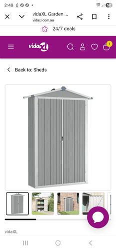

 I found this slim shed. I thought leave off back wall and attach the 3 x sides . Wot do u think

Hello @Trishbo
Welcome to the Bunnings Workshop community. It's sensational to have you join us.
Thank you for sharing your idea. Its construction looks like it will totally cover the battery. However, I don't see any ventilation options which could trap heat inside the structure. Large scale domestic battery systems have very strict rules in regards to covering the battery unit.
Just a friendly reminder to all our members to double check with your battery provider on what is allowed to cover your battery unit before you make any changes.
