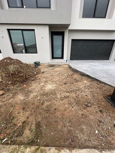

Hi guys. New to the outdoor home DIY world but want to give it a shot to save on money and give myself the satisfaction of completing some home Diy tasks.
Im planning to put a stepping stone/paver path with pebbles towards my front door. So my question is how much allowance in depth am i supposed to give myself for road base(or alternative base), compacting ,weed barrier, paver and pebbles. Planning to use a 40mm limestone paver. Also, would the pavers need to be cemented or concreted to the surface.
Also, there is a slight slope, not much. So any tips around this would be helpful.
Another question. My front yard base feels like it is clay. How much mm in underlay would be required for me turf the yard.
Looking forward to hearing your advice.
Thanks
Mark

Q - Im planning to put a stepping stone/paver path with pebbles towards my front door. So my question is how much allowance in depth am i supposed to give myself for road base(or alternative base), compacting ,weed barrier, paver and pebbles.
A - Considering that your yard is clay maybe not a lot will be needed, mainly to raise your pavers to the height you want them to sit at. I would suggest to have the pavers at least in line with the height of your driveway.
Q - Planning to use a 40mm limestone paver. Also, would the pavers need to be cemented or concreted to the surface. Also, there is a slight slope, not much. So any tips around this would be helpful.
A - I like the sound of the thickness of paver, my only suggesting before starting even with road base is to lay the pavers about in the rough area you want the stepping stones to be so as to get the right feel of taking steps, Every ones step distance will be a little different. Once you have decided on the distance then you could use some mortar under the stepping stone to lock it in place. Tho I would leave it free and resting on clay as that way I can shift the path around
I would also have an area that is deliminated by say white pebbles with weedmat down first.
Q - Another question. My front yard base feels like it is clay. How much mm in underlay would be required for me turf the yard.
A - Mmmm guessing here but id say at least 50mm if not 100mm of soil plus turf.

Thanks Dave for your reply and great advice.
Just a question in regards to having pavers in line to the height of my driveway. As my driveway is horizontal to the planned path i intend to do with the stepping stone path. What would be the best way to work out the height of where the paver would sit in line with the driveway height? Would running a string line horizontal from the planned path to the driveway work out?
Kind regards
Mark

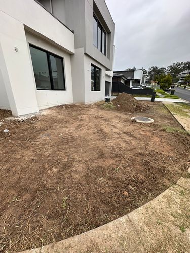

My question is: the front porch is slightly higher than the footpath (seen in picture 2) which the path will be connecting to therefore there will be a down slope from porch to path. How do i navigate around excavation around this? if that makes sense.
How would i plan a nice even slope for excavation? im thinking a string line or using a long structural framing timber piece?

Using string lines is the perfect way to get a nice even gradient for your pavers. This will give you a physical point of reference that you can use as a guide.
My suggestion is to excavate the area below your finished height. Set up your string lines on either side of the path and add your drainage gravel or road base up to the string line.
You can use a long piece of framing timber to assist with identifying any high or low spots, or you might like to consider a Masterfinish 3m Straight Edge as they are manufactured perfectly straight, and they don't have the variables that timber does.
