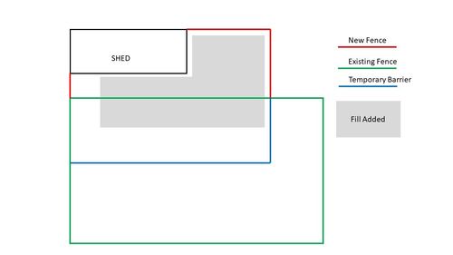

We’re building a shed next to an existing colorbond fence. We plan to remove 20m of the fence and then add fencing on each side of the shed connecting to the existing colorbond fence. The existing colorbond fence has a buried sleeper on the bottom to keep snakes and toads out so the enclosure is safe for our dogs.
We will be moving a lot of fill in to build up the level inside the fence to the height of the shed slab so the idea is to add a temporary snake/toad barrier in the middle of the existing enclosure. The barrier will need to be about 30m long.

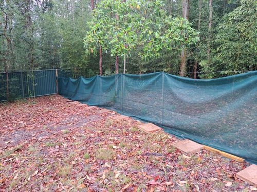

Hi @Dave-1, Interesting idea to use metal or poly sheeting.
Since just need temporary barrier for 3-4 weeks, I've come up with a new design to minimize materials.
I plan to put row of hardwood stakes with wire strung across the top that I can drape shade cloth over.
The bottom side will lay flat then stapled to 100mm strips of plywood that I'll hammer into a slot I cut in the ground.
In the past I used an old axe to create the slot in the ground but wondering if I can use old jigsaw or circular saw that I don't mind getting dirty.

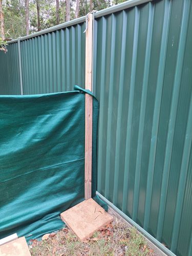

The ends will be mated to a colorbond fence post where I'll brad nail a piece of thin pine trim to a 70x35 board.
The pine trim will fit into the indention on the colorbond fence post where the 2 halves are joined.
The top of the 70x35 will be zip tied to the top of the colorbond fence post.
A horizontal board will be nailed to the bottom of the 70x35 and a wood stake will be used to push it against the bottom of the colorbond fence.
Probably put a cinder block next to the fence on top of the shade cloth to seal the corners.
Thoughts?
Thanks

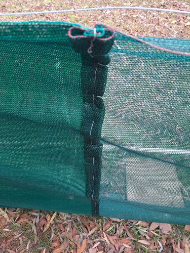

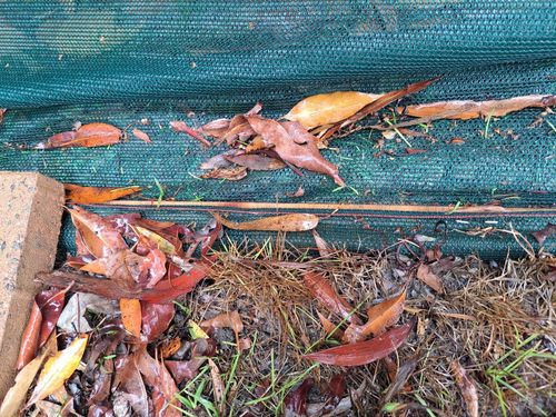

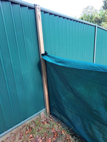

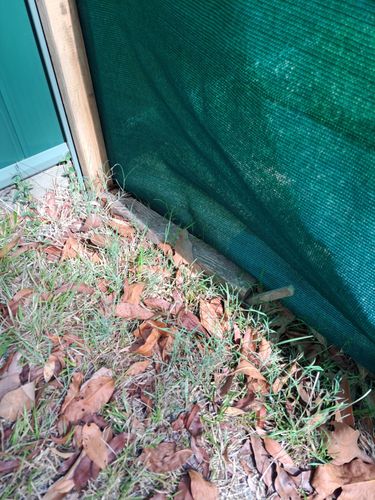

Hi Eric,
I ended up just using a shovel to cut an angular slot, then hammering in the 7mm wide plywood slats with shade cloth wrapped around them.
Put some 400x400 concrete pavers on them to keep bottom in place. Here's some photos of the finished project.

Hi Dave,
It's never good enough that you don't have to worry about snakes, it's amazing where they can go..
I inspect the buried section of the temporary fence regularly and haven't seen evidence of penetration.
But their entry will probably be below a color bond fence gate.
We have 200mm sleepers buried 100mm under the fence and removable sleepers with a concrete slot under the gates.
I put weather stripping under the gates but snakes can still slip through.
There's also a double gate and I haven't gotten around to putting in a vertical weather strip on it.
