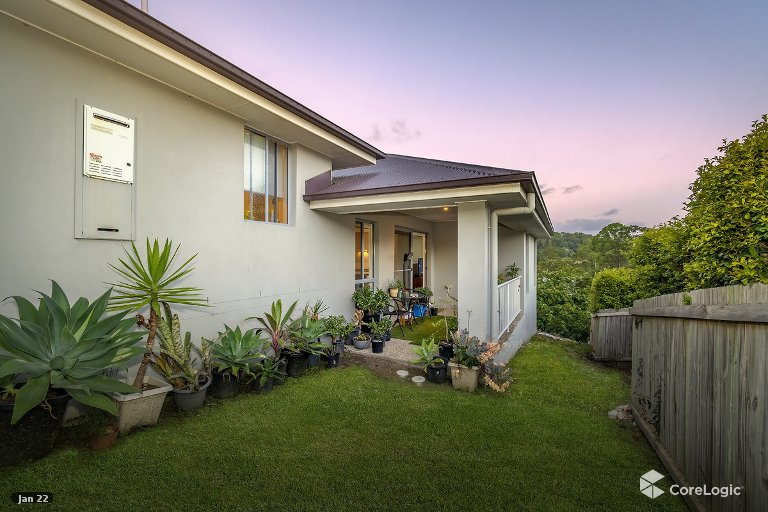

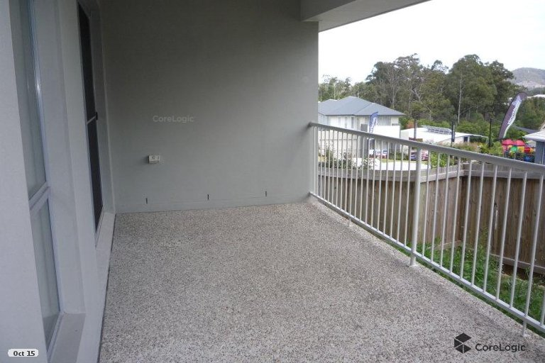

In order to give you better advice, would it be possible for you to post a photo of the area where you plan to build your deck? We can then assess the condition of the area. Our members can then make recommendations on how to proceed.

Thanks for the information, here's a few pictures. We've already got a patio, just wanting to put timber over the top and a new timber railing. image (1).pngimage.pngimage (2).png

Let's say for example you have a usable height of 100mm, if you were to use a timber frame of 70 x 45 that would leave you a space of 30mm. From that 30mm you need to subtract the thickness of the Merbau decking panel which is 19mm. The remaining space would be 11mm, it's this gap that will be at the bottom of your timber frame. In ideal conditions, you would want more, but if we were to raise your decking higher it will now become a tripping hazard to anyone coming out of the house.
When you draw your decking frame plan, it's important to consider which direction the decking panels will be laid out. How you layout your decking frame will dictate which way the decking panels will face. This would also be a good opportunity to consider if you'll be building a picture frame or keeping it simple with a single panel border. These are some of the things you'll need to consider when making your initial plan.
I suggest checking your local council for the rules and regulations on how high the timber railings should be. Here is a good example of a framing layout that you can refer to - Low-level Merbau deck over a concrete slab by @Neo19.
