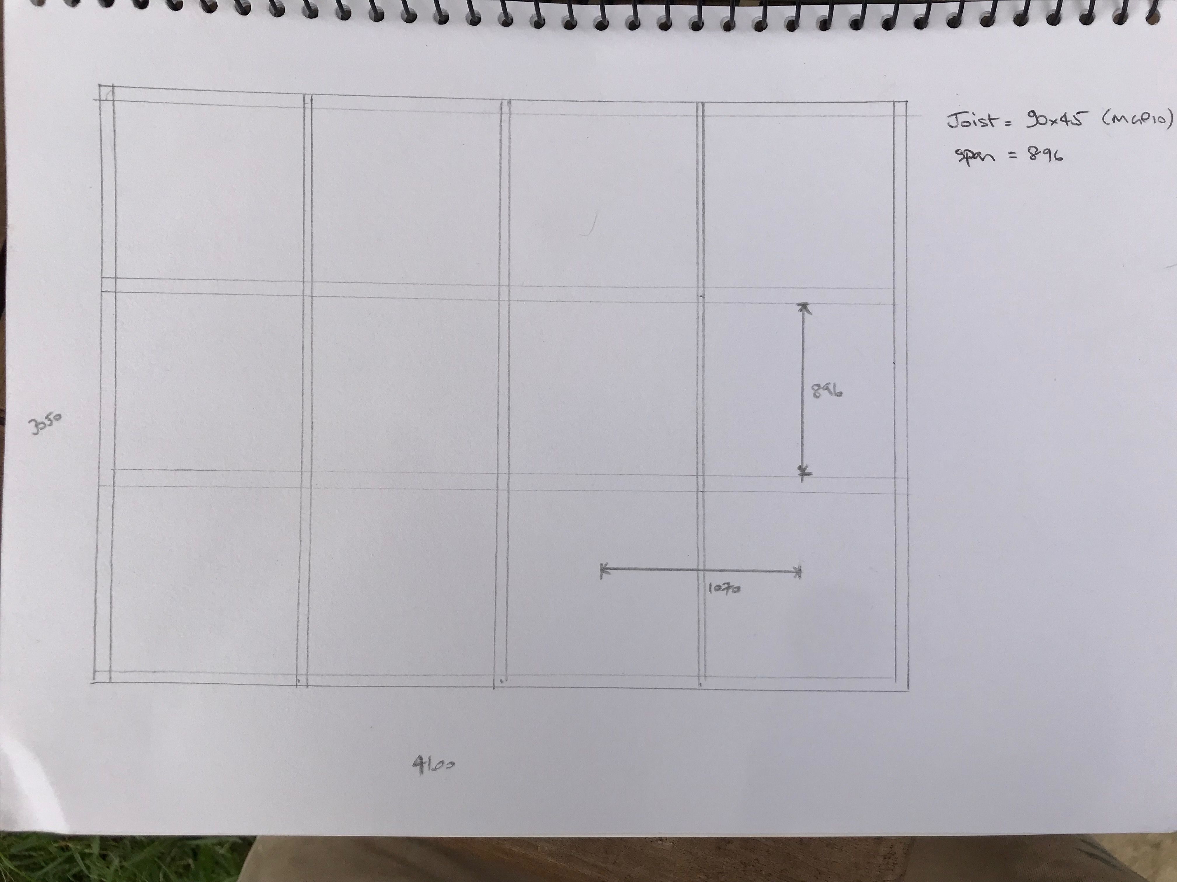

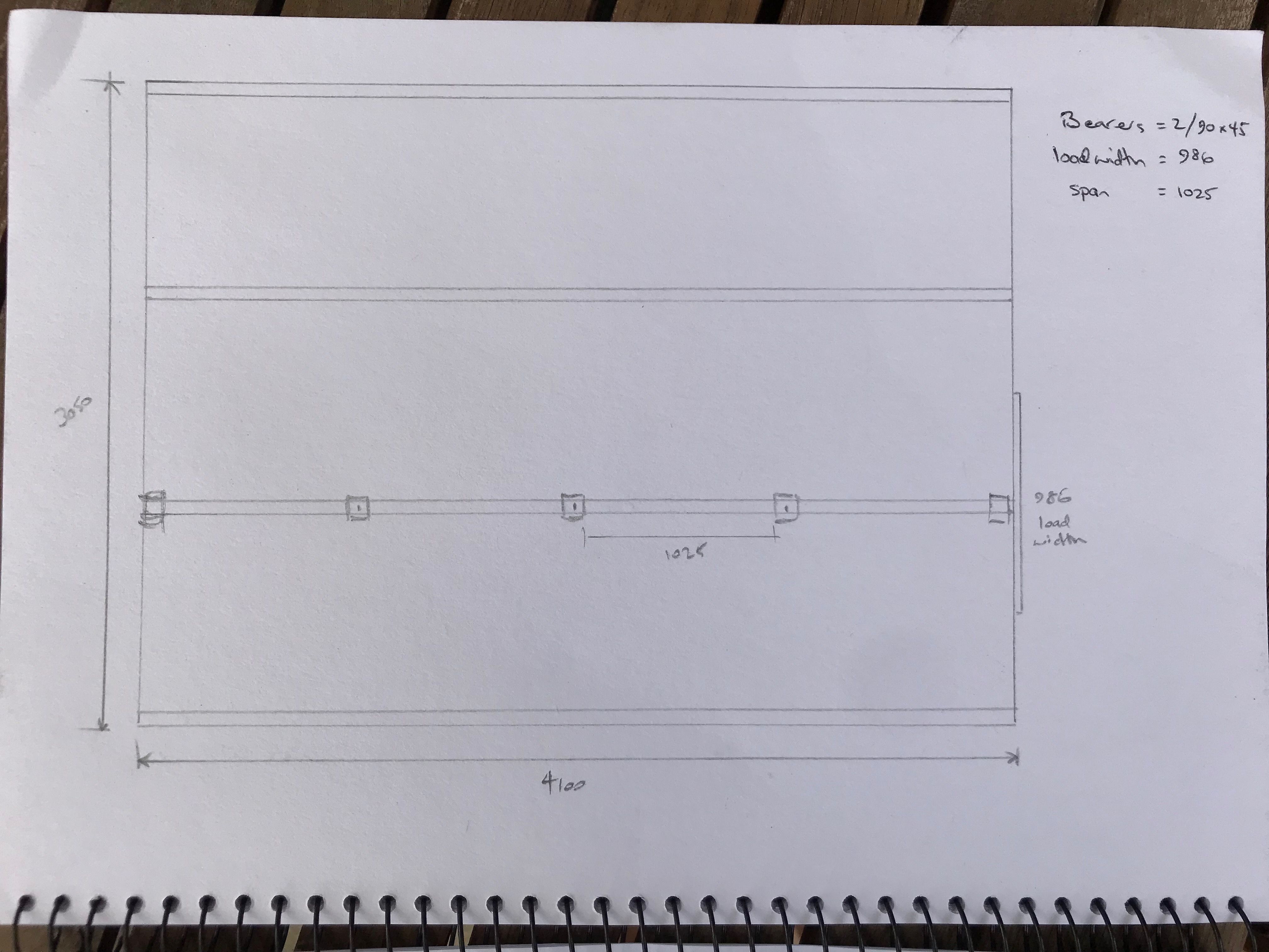

Hoping you can help with a deck design.
I'm working from The Australian Decks and Pergolas Construction Manual sold in bunnings, but for the life of me can't make sense of the span tables. Or at least the design I'm coming up with doesn't seem right.
The deck is planned to be 3300 x 4100, Bearers running along the length, joists mounted ontop. The deck is only 500mm of the ground, and doesn't require a DA.
Bearers - 2/90x45 MGP10
Joists - 90 x 45 MGP10
Posts - DINGO 100 x 100 x 900m 6mm Reinforced Concrete Stump (as per the bunnings DIY video series.
The span tables seem to suggest a joist every approx. 1000mm, but every picture I see of a deck seems to have joists at 450mm.
Have attached the drawings fyi (and can provide the span tables in the back if it makes any difference! Any assistance from anyone would be greatly appreciated!!!
Note: the width of the deck has extended some I’ve drawn this. It’s now going to be 3300 wide.

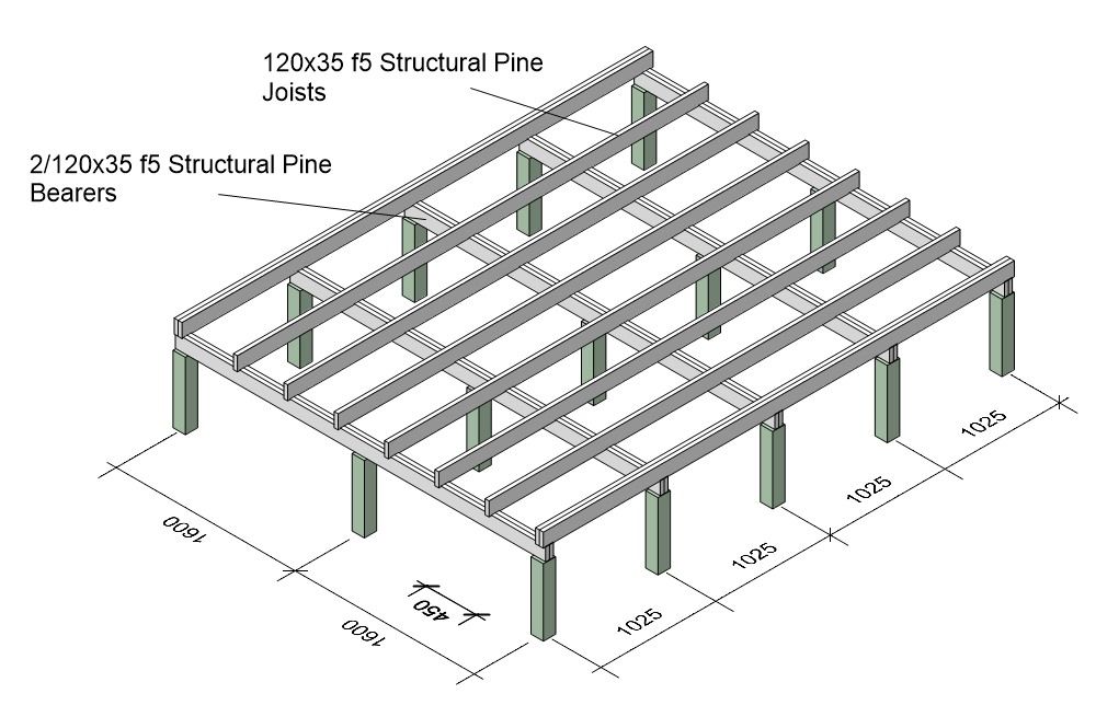

For a 4.1m Length x 3.2m Width deck
Stump Locations
Width 3 Stumps (2 equal width 1.60m centres)
Length 5 Stump (4 Equal length 1.025 centres)
Bearers
2/120x35 f5 Structural pine 3.30m long
at 1.025m centres Nailed or bolted together
Joists
120x35 f5 Structural pine 4.10m long
at .450 centres for pine Decking or 600 Centres for hardwood decking
The decking generally limits the joist spacings centres either to 300,450,600mm
The current code is AS1684.2 Table 49 & 50 Bearers & Joists Respectively
Domestic Timber Deck Design for guide to decking Types,Sizes & Spans
Please leave a PM if you require further info on AS1684 or if you would like a free Sketchup Model

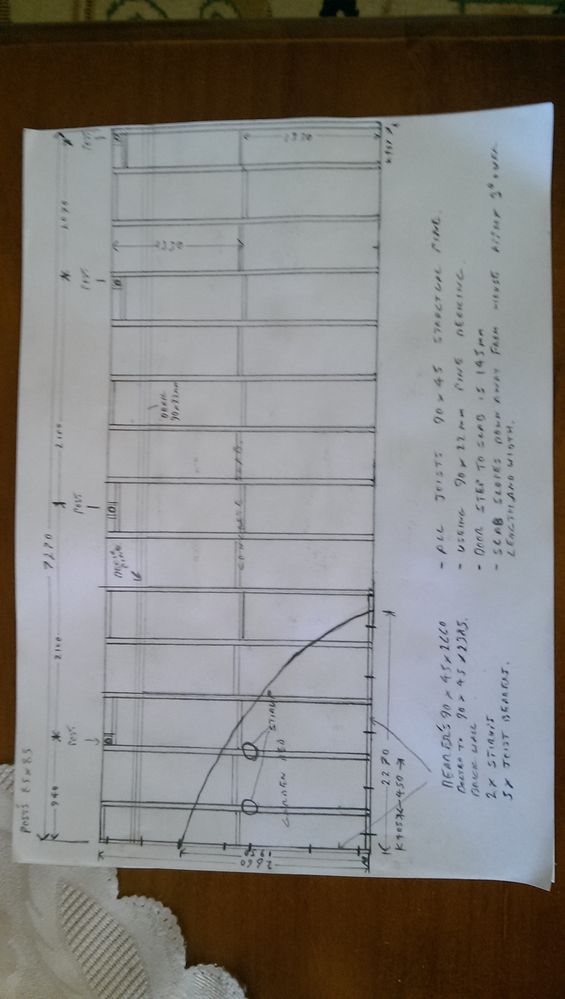

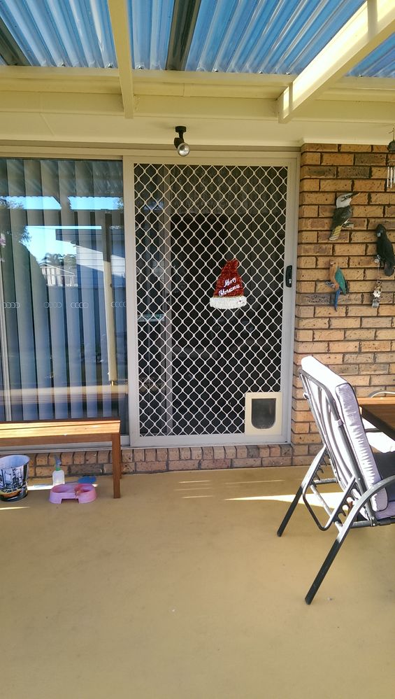

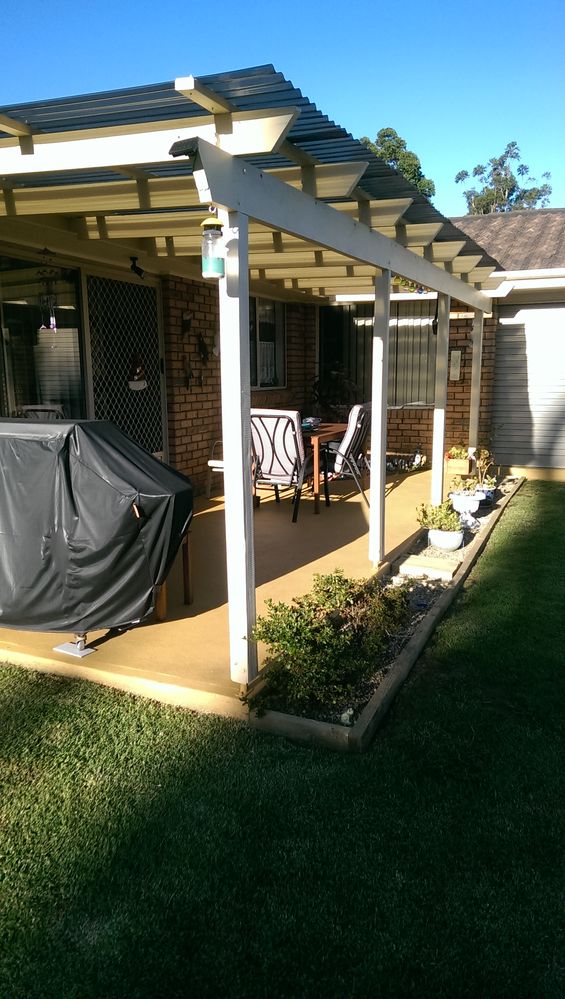

but I will be asking many questions as I am about to endeavor in building a deck over existing concrete slab and around the back of the house over earth and concrete slabs ( when I can work out how to upload photos to this thread rather than start a new thread I will)
I have fare idea on what I have to do but any advice would be greatly appreciated!
I need to build the deck to eliminate the 140mm step down as my mother is having a difficult time doing so and budget is very tight as I am on a carers pension! I don't mind getting down and dirty ![]()
the area I have to sort is 7270 x 2660 , the existing slab slopes away from the house at approx 3deg .
I intend to run decking length ways using 90mm x 22mm pine board
joists will be 90mm x45mm using concrete bolt screws and window packers to level off! set at 450mm spacing but both ends will be around 405mm gap.
over the section of garden bed in corner I will use 90 x 45 bearers bolted to brick to support joists using joist hangers and 2 stirrups set in concrete and weed mat.
I will be repainting slab a dark grey or black so as not to see it through the gaps in the decking which will be, as advised 4mm - 5mm.
I would appreciate any advice on this project
