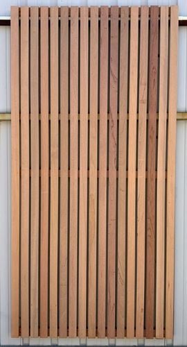

I am wanting to create a timber feature on the front of our brick home. It is just a small area. The timber would run vertically. I know I need to attach horizontal battens to the bricks and attach the screening to that. I am wanting something similar to the picture attached. Happy to treat/stain/varnish etc. Whatever is needed to obtain that look. I just don't know what the best type of timber to use is. I'm also happy for the timber to be a little wider. Please let me know what you suggest.

An easy way to recreate the look is by using SpecRite 1800 x 902mm Pre-Oiled Merbau Alternating Slat Fence Panel, but it has that dark colour. If you're after a lighter colour, I suggest looking at 90 x 22mm Decking H3 Treated Pine L/M. You'll need to season the timber and then you can stain it to a colour that you like.
I also suggest having a look at this discussion - Feature wall fence with Matrix screen panels by @diy_hausdesigns.

The timber slated panels I used that @Dave-1 & @MitchellMc were thinking of were just DAR pine which is really only suitable for internal use even when painted or stained. That look your'e after I have also done as a privacy screen using 42mm x 18mm pre-oil Merbau screening. Alternatively a cost effective method is the SpecRite panels @EricL linked in his post.
