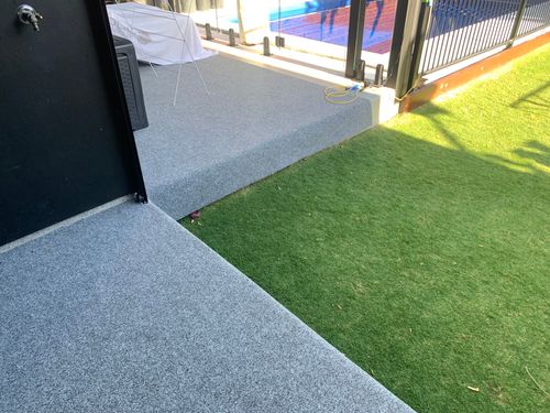

We want to build a small triangle deck so we can walk across the 250mm high gap, pics attached.
Would be very grateful for some ideas please. It doesn't need to be attached to the slab. Thank you!

You should be able to assemble a triangular-shaped deck quite easily, as it's no more complete than a rectangular deck. Start by checking out this guide: How to build a low-level deck.

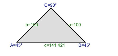

I've created a few renderings to show you what the structure could look like. I've used 90 x 45mm H3-treated timber and 90mm Merbau decking. The framing timber can be fixed together with galvanised bugle screws, and I'd suggest two for each joint.
The deck platform can be raised to the correct height on pavers or pedestal feet. The pedestal feet are great because they offer a huge amount of adjustability.
