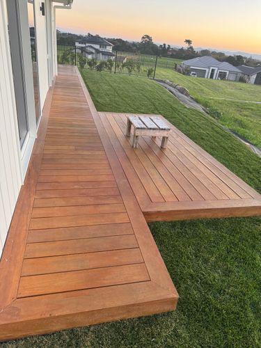

Hi I’m planning to build a wooden paragola for the outdoor deck. PFA a photo of the deck for reference and a photo of what I have in mind to build. Would like to know what size of pillars should I use and what would the ideal wood be for the purpose. Would like to have a hammock placed as well in between the pillars so would like the pillars to be able to take the weight. Any suggestions will greatly be appreciated.

Hi Eric as long as the Pergola’s less than 30sqm an approval isn’t required. Mine is probably gonna be appx 1.5x3.6 only on the protruding part in the deck where you can see the table kept. In my opinion too small a project to involve a draftsman. Any suggestions will be greatly appreciated.
