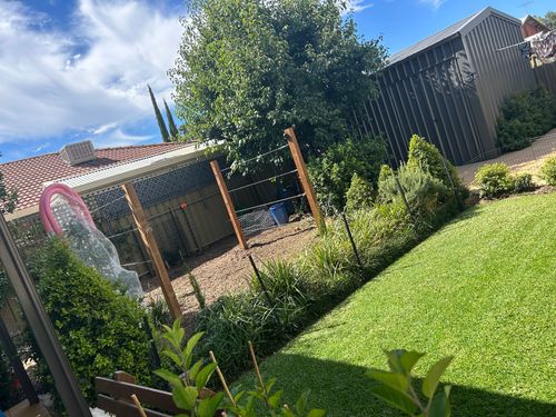

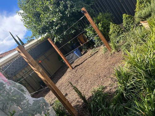

Well I did it! And I’m pretty proud of myself for a chubby 48 year old lady! It’s not perfect but I had a good go at it and in a few years hopefully I’ll have a lovely lot of apples. 🙂 thank you so much for your advice.
That looks sensational, @jen8; well done!
Thanks so much for coming back to us with your results. I trust they will inspire many of our members to give something similar a go.
Great work @jen8. You should be really proud of your achievement.
