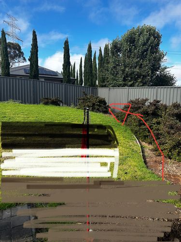

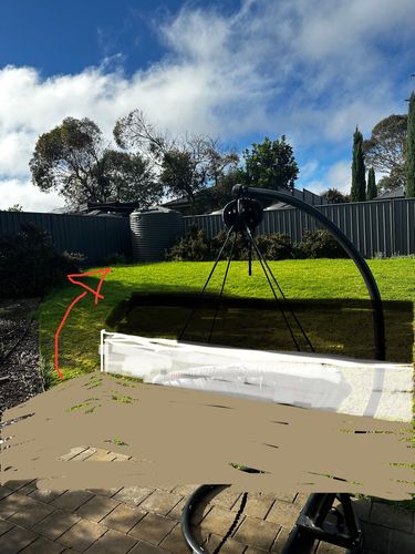

I’ll attach a couple of pictures (not great). The brown will be extended pavers. The white will be a retaining wall less than one metre, probably closer to 600mm so we can use it as seating too. The red arrows show where we are thinking of building stairs (right side) or a ramp (left side).
Because I’m unfamiliar with terminology etc. is 1:14 where for every 14m the slope increases by 1m? I’ve been looking at pebble lock. Is the geotextile under it meant to be permeable? So that water can somewhat seep through? Can you do crushed granite with pebble lock? That doesn’t sound right does it? And then at the base of the slope I was thinking of running that grate and channel drain all the way along the base of the retaining wall. So am guessing I’d just continue it along along the base of the ramp where it meets the pavers. Maybe it wouldn’t work with pebbles because they’d wash into the grate?

I agree with your analysis regarding the crushed granite and pebbles, they will get washed away into the drain at the bottom. Have you considered using pavers to create the ramp? This would work well with your idea of placing a grate and channel at the bottom of the ramp to catch any water flowing off the ramp.
Another option is to create long landing steps made of pavers going up the slope, think of it as long mini steps. The advantage of this is that it will prevent water from rushing towards the bottom of the slope.
One other way is to make it out of cement and colour it with oxide so that it blends in with the surroundings. But this is more of a long-term installation and is difficult to remove and modify.
Pebble lock is a fantastic product, but I don't recommend using it on a slope with small pebbles or crushed granite where it might get washed away in the rain.
