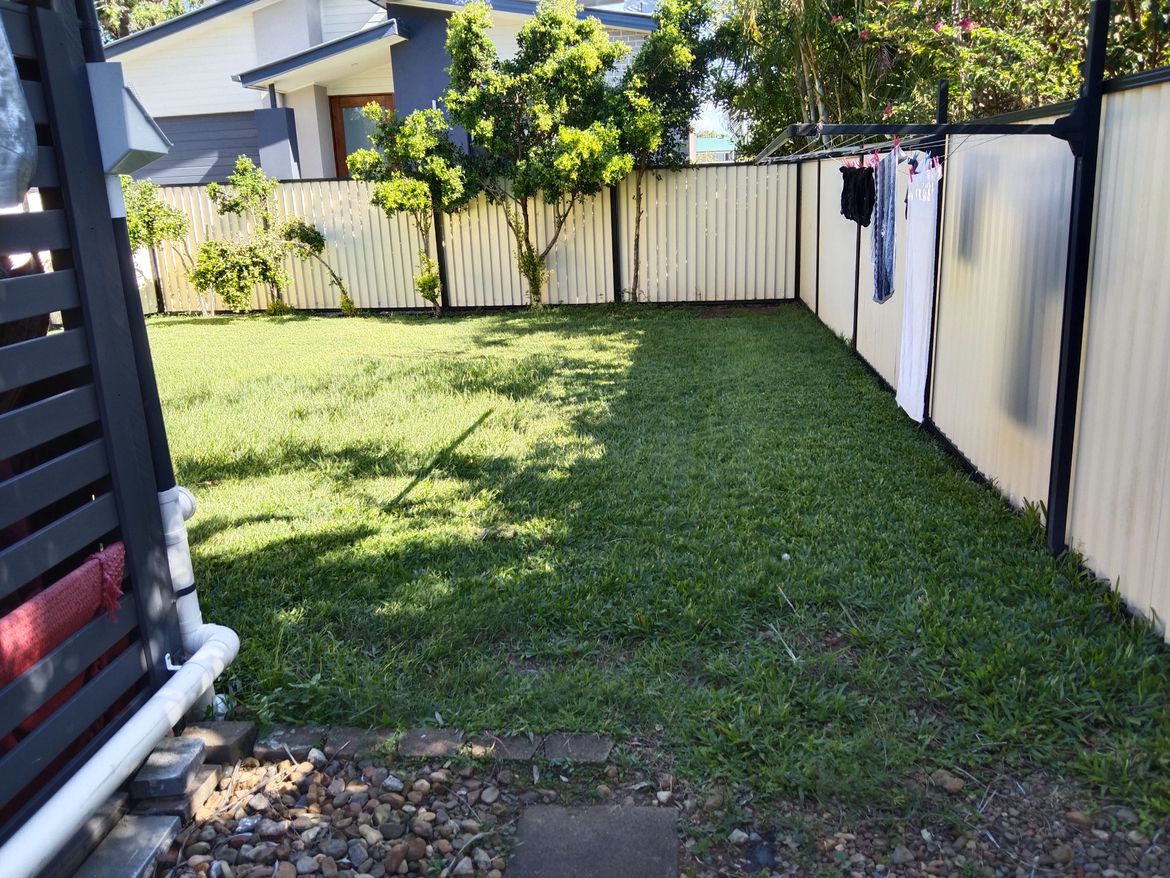

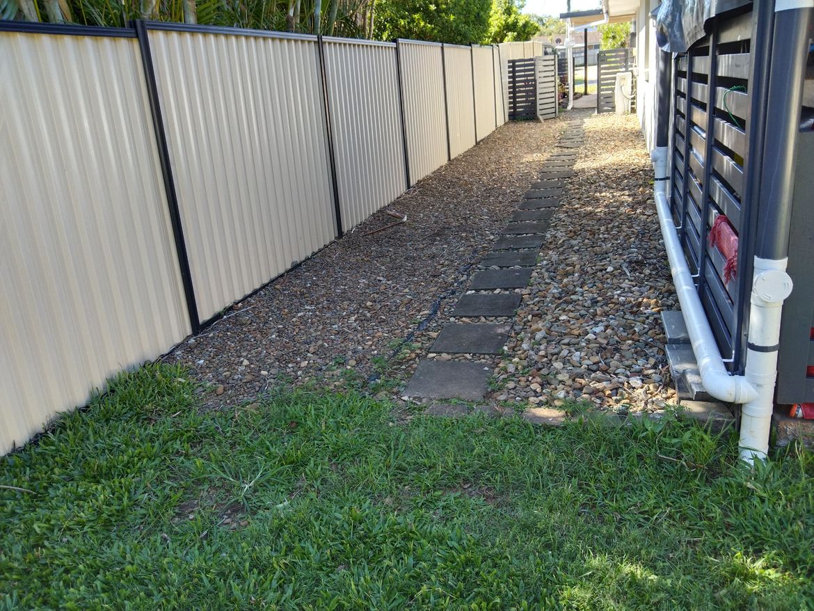

I have a older cat who wanders (he is desexed) and would like to keep him safe in the back yard when I'm out. I'd like a budget DIY option if possible. The barrier would be around 3 M long, from the washing line post to the rear patio post, which would be on a slant, but I'm not concerned about what it looks like. There would need to be a latch or some way I can come and go. There's colorbond fence all around the house and at the moment he jumps over the front fence at the side (first photo), so I'd like to set up a barrier at the side / rear that I can rig up myself from materials I can carry home in my small car (Picanto).
Any suggestions welcome. Thank you.
