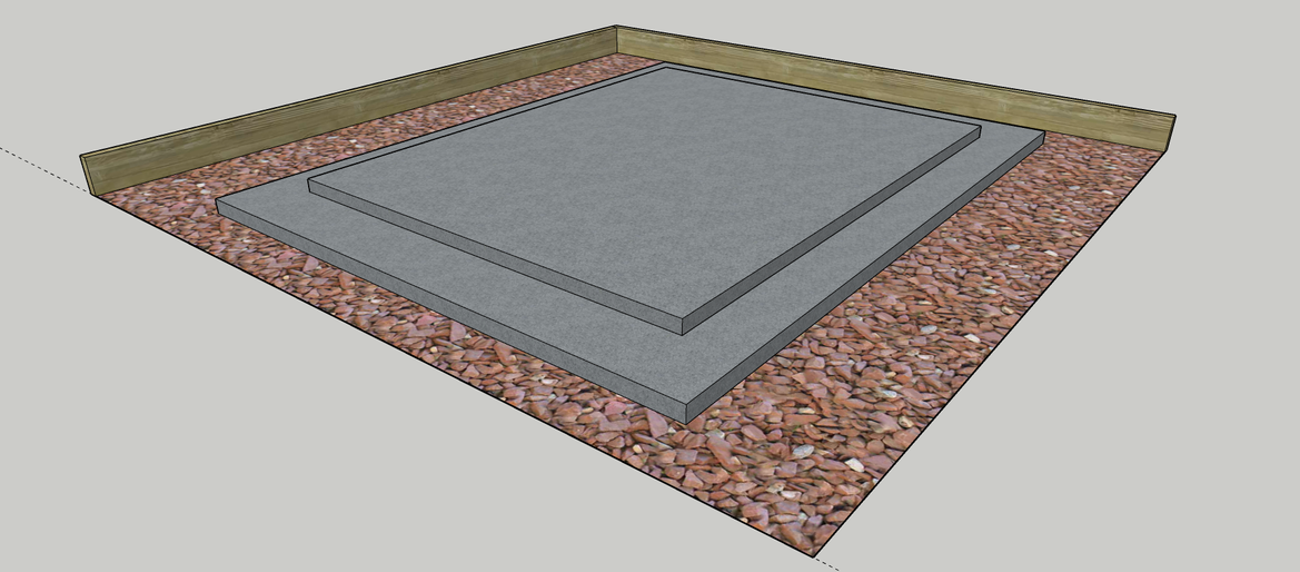

I've placed a sample image of the slab with a raised section to give you an idea of how it can be built. You'll notice that there is a raised section of the slab this is the interior size of the shed floor. In essence when the shed is assembled this raised section is inside the shed thereby preventing any rainwater from flowing in. You can also see the small retaining wall at the back.
