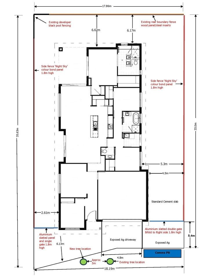

The 65mmx65mm is the size aluminum posts I was thinking of using and in ground mounting prior to having the driveway slab poured.
I mentioned strap hinges and bifold hinges, as I noticed these on another automated gate site. I could decrease the double gate span to a minimum of 3.6m to keep the weight down.
Plus I have noticed spring loaded gate wheels, similar to what Bunnings have, which I could use, as long as they seem to meet the requirement.
Have attached a plan of the house and fencing. The gate is at the front right side of the house.

Good morning @GarthT
When you say Aluminium posts, I am thinking steel posts. Just clarifying as the difference in weight carrying coukld be a factor. (I am being cautious is all) I prefer steel posts mainly due to their strength.
The spring loaded wheels are what i was thinking to help carry the load of the gate so it wont be as likely to sag. If you use the spring loaded wheels plus solid posts you really shouldnt have to worry about the weight. I would possible think of a sliding large bar across the "bend points" of the gate to help keep it ridgid in the wind and at the same time more secure. (Think like a castle gate securing bar. between the panels)

Thanks for your feedback back Dave.
I agree, I could use steel.posts, plus I would be attaching the hinge post to another post a perpendicular colourbond fence running down the side of the property boundary. Also, if the Biifold becomes too difficult, I could always do a wide single gate (3.5m-4m), with wheel a support at the latch end. That will depend on the opening swing distance on the driveway. Then add a panel to fill in the space against the house.
