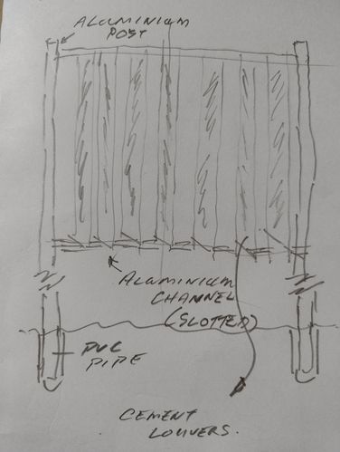

Hi @Sugar,
There was a recent related question:
https://www.workshop.bunnings.com.au/t5/Outdoor/How-to-build-a-solar-battery-cover/m-p/328875
I saw no reason the protect the sides so for a few people I came up with this.
Think of a garden shed louver window on it's side.
The idea was to provide sun protection with air flow between the slats.
If needed the whole thing can be lifted out and put aside for access.
That could be automated with servo/linear actuator using Amazon Alexa and Smart Life providing remote access to manually control or automatically open/close via a temperature sensor.
