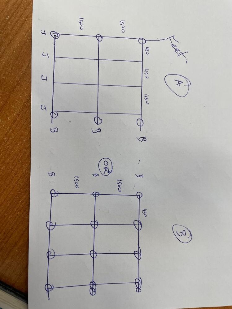

looking at building composite decking in backyard.
Want to use builders edge adj pedestals, if use size bigfoot xl and use bearers 145x45 then can space feet at 1500mm on each bearer when joists are 450mm spaced.
But question is do i need also need feet on every joist also at 1500mm apart ?
figure A or B?

You could use the orientation shown in Figure A.
Bearers need to sit on posts or pedestals, while joists can be supported exclusively by bearers as long as there is a structural connection between the two, which can be created by using joist hangers with Connector Screws
If you are using 140x45mm framing, then the pedestals would need to be spaced at no more than 1400mm apart. This can be seen in the Hyne Timber Bearer Span Table.
If you also use 140x45 framing for your joists, then your bearers could be spaced 2600mm apart, which would mean the spacing between your bearers can be increased if you would like to. This can be seen in the Hyne Timber Joist Span Table.

Had planned on 140x45 bearers and 90x45 joists,
so pedestals then 1400mm apart on each bearer for support and bearers 1400mm span apart, that looks right doesn't it?

Yep, those spans are correct if you use 140x45 for the bearers and 90x45 for the joists.
Yes, that is correct, joists don't need to sit on bearers as long as you use a joist hanger. They reduce the height needed to build a deck greatly, and you'd find most carpenters build decks in this way nowadays.
