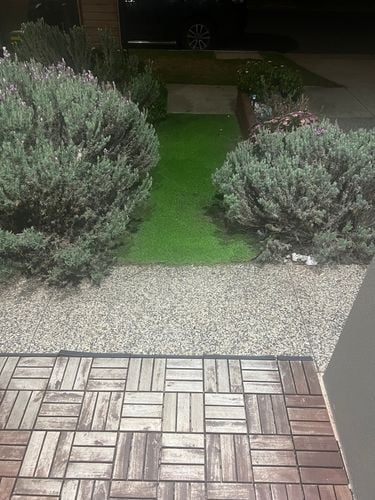

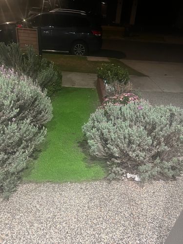

I am trying to put deck steps in my front yard that is concreted. It’s 1.25m wide with a height difference of 36 cm. Also the length is 3.9m.
i am not getting any solution how to out the deck steps on it.
attached id the photo. Looking to put deck steps on the turf and it’s concrete underneath the artificial grass
Welcome to the Bunnings Workshop community @anishgupta. It's fantastic to have you join us, and many thanks for your question about creating steps on a slope.
With a height difference of 36cm you could only do two steps within that space to comply with min/max rise. I'd suggest creating two platforms over the slope. I've created some renderings below to help illustrate possible construction techniques.
Given these are virtually mini decks, take a look at this helpful guide: How to build a low-level deck.
