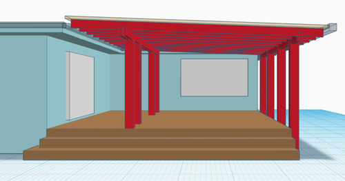

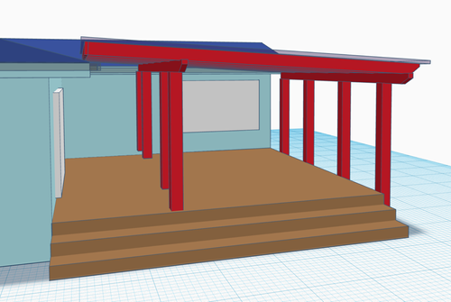

We are building a polycarbonate roofed pergola over a deck, see model below.
We will run spouting on the lower side and tie into the house spouting.

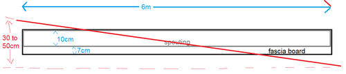

We live in a windy area. The pergola is engineered for the wind, has 200x200 house posts (8 of them) with 2/190x45 beams and 190x45 rafters on 600 centers and will have purlins or noggins. It's also tied into the deck. The problem is that it's quite a long length of almost 6m and by the time you get to the far end if you have a 5 degree pitch you loose 50cm in height. If you have a 3 degree pitch you only loose 30cm in height. So we are thinking of using a 3 degree pitch roof using 5 rib polycarbonate which is rated for 3 degree slope.

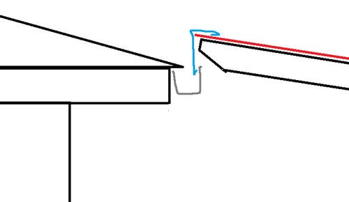

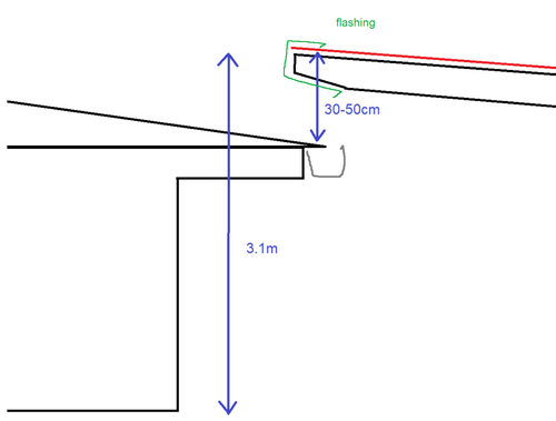

I thought I would run the top part of the roof over the top of the existing spouting or even could potentially run it a little over the roof as well. Something like this maybe? We do realise that it wont be completely water tight and it is an outdoor area. But we want to minimse water coming in through the gaps.

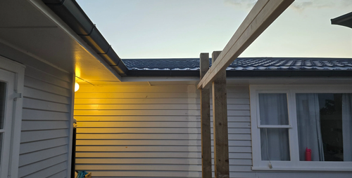

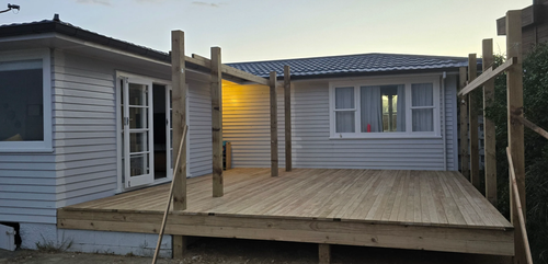

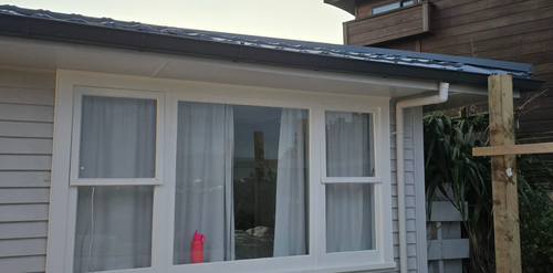

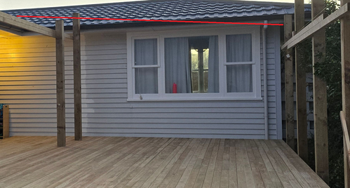

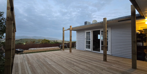

Here are some actual photos of the deck / house. I am not sure about the interaction between the side of the pergola roof and the side of the house (spouting/fascia/eaves). The problem is the side of the pergola roof will go from above spouting height, to alongside spouting height, to below the spouting height. ie. there is a 30cm drop in height (3 degree pitch). The spouting height is probably about 10cm and then there is about 7cm of fascia below the spouting.
Can I please get suggestion on the top flashing and the side (barge) flashing.
If I have both the upper end of the pergola roof and the lower end of the pergola roof above the spouting it ends up quite a high roof.

I actually like either option you have drawn tho if I had to choose between them I would choose the higher roof (second option) with the flashing piece down towards the tiles. Main reason is for cleaning the gutters out. The first option works but lessons the overall width inside the gutter to get your hand in, with the second option the roof may be higher but maintenance wise it will be a lot easier.
I have a gap between my roof decking and the house. I was going to use some lead flashing when I originally designed it but $$$ and time it never got done. Truthe be told not a lot of water comes through there and something like a right angle flashing edge might do the job, pretty much as you have drawn.

I would probably go with your first configuration with the roof of the pergola in line with the gutter of your roof. I've seen the configuration of the pergola roof over the house roof and has caused the rain to bounce off the roof and into the pergola itself.
Your proposed idea of having flashing over the gap and into the gutter is best. It provides adequate coverage and prevents bounce back of any rain that should land in the area. I suggest visiting your local store and speaking to the team at the special orders desk regarding ordering a custom galvanized flashing for your pergola.

Just had another thought. If you wanted the low roof more so then you could potentially install a wider gutter and still do the flashing into the edge of the gutter and be able to clean the gutter as needed.
The problem with the first option is the side of the pergola roof goes like this:
Although, maybe it's ok to just have a 1cm gap between the side of the roof and the gutters and except 1cm strip of rain?
I cleaned the gutters for the first time this weekend in 7 years, and they were pretty much empty. So I'm not too worried about accessing the gutters.
