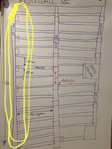

Hi @Trentc,
It looks like you already have your footings at 1000mm apart, which is fine. Your 140 x 45mm joists span 1600mm between the bearers, and this is within span requirements.
I'm happy with your layout.

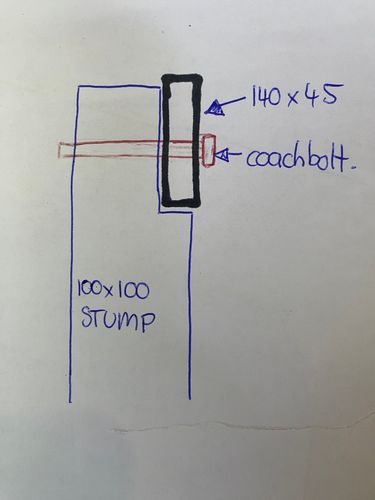

would my design of footings work as I’ve drawn a picture or is there a better way?
Re: How to build low-level deck frame?
Hi @Trentc,
That will work, but I'd probably go for two coach bolts at an angle as per below. You could also use Landscape screws.

 the section I’ve highlighted would I need footings or would it be enough if that timber is dynabolted along the brick work?
Is it double-brick or brick facade @Trentc? Bolting a ledger board onto single brick does not comply with the construction code, as it's not designed to take a lateral load. The bolts must extend through the brick and into the structural timber subframe.
Trentc
Growing in Experience
It would be just a single brick wall, I’ll just do stumps and sit it off the wall slightly then
