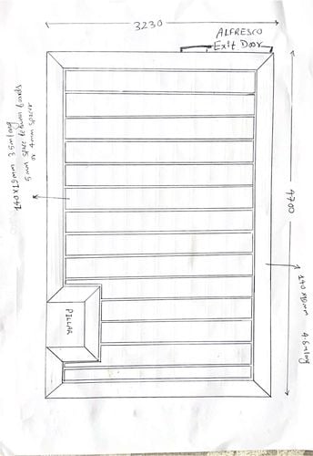

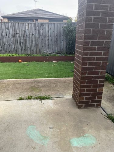

Hi there,
I have been planning this deck project for long now in the alfresco. I have finally did my homework and draw my plan for the deck. I have attached my plans and estimate cost for all the materials I need.

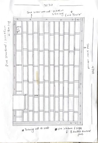

My alfresco depth is 140 cm so I have to choose 90x45mm structural pines. My calculation says I’ll need all together 15 structural pines so I have added 1 extra with 400 cm gap in between.
I am going to screw the structural pines into the wall in 2 side and in the pillar. Rest I’ll add L shape brackets or timber for weight support.
I have calculated my deck boards (140x19mm) through deck calculations https://www.calculateadeck.com.au
which gives me 22 boards with 125 L/M and 575 fixing screws needed. I am choosing 5.1 m long X 4 boards for picture frame and 3.9 M long X 20 boards for rest (few extras). I’ll use 4mm spacers in between the boards and screw in every 400 cm.
I hope my calculations and method for the decking is right and want to know any improvements or different methods.
