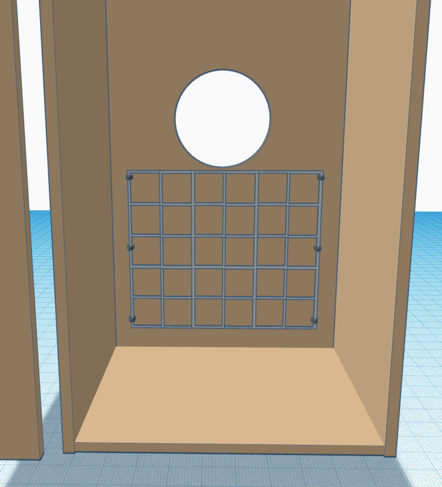

I've put together a rendering of a possum box I built alongside Wires and with the assistance of the Men's Shed. I think we made over 50 of them. We stapled mesh inside the box to allow exit. It's a relatively simple design that can be made from marine-grade plywood and then coated with exterior water-based paint.

Assuming the possum box is similar to the design @MitchellMc as shown above and is not excessively heavy, you can use Ramset 10 x 50mm DynaBolts or Ramset 6 x 50mm Galvanised AnkaScrews directly through the back wall of the possum box into the wall. I would suggest four of these anchors, one in each corner.
