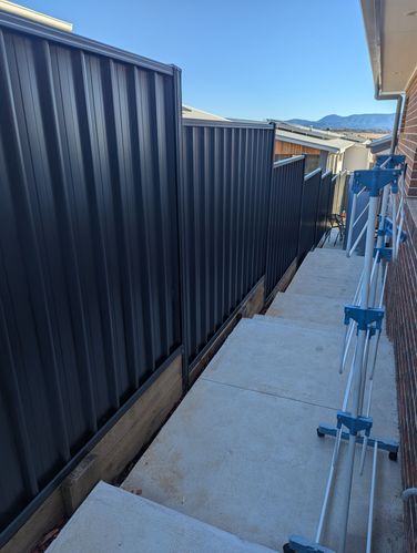

We want to plant screeners down the service side of the house where there's limited space (eg about a metre wide). Want the plant to grow above the fence height outside the windows. There's also stairs we need to navigate. Is there a planter we could use for this purpose or should we look into building our own planter boxes. Is there enough space to do this with a thin creeper.

As your planters would be sitting over concrete, anything you use would need to have a bottom to encapsulate the dirt and prevent damage to the concrete.
In terms of premade planters that fit the description, I'd suggest you have a look at the Vegtrug 91.5 x 35 x 223.5cm Natural Partition Planters. They are fairly narrow, raised with a bottom so they can sit on concrete, and they come with a 2.2m tall frame that climbing plants could use as support.
You could also look at using trough planters, which have a bottom and are both wide and narrow to allow for the screening effect you are after.
Using a trough planter, you could then use a technique like the one @Gwandalan_Tales used in their project Star Jasmine fence screening using wire. This would utilise the fence to create a structure for the plants to climb

Good Evening @Poppy2023
I think you will run into probelms with the width of space you have to play with, not sure how much year round shade you get down the side either. I was wondering if you could attach a higher screen to the top of the fence for your window sections? colourbond fence extension shows you a range that you could use. You dont need tehm the whole length of the fence, just the windows. I would have a chat with your neighbours as Im sure they wouldnt mind that privacy as well.
If you go the route of planters I like the idea of trough planters but you will still need to add some form of extension to the top of the fence as I think if it was within the planter there would be too much pressure if the wind picks up (at the top) and would tend to tild any pot. A walkway needs to be 800 mm wide at least so you have around 200mm to play with.
