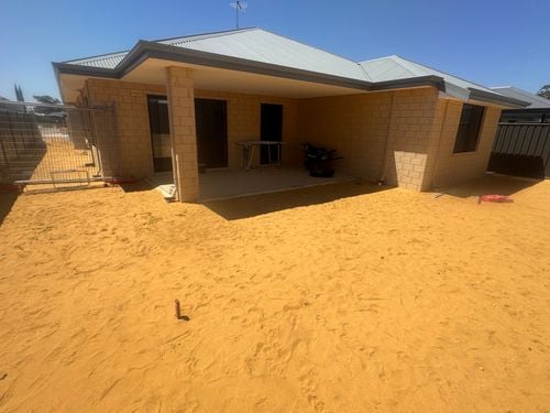

will be removing paving and clearing more sand finish level will be around 250mm. Thinking double 90x45 as bearers and 90x45 or 70x45 as joists looking at those 300mm 450mm Galvanised stirrups to rest bearers. Thinking of fixing joist framing to the limestone bricks and again at the lime stone pillar

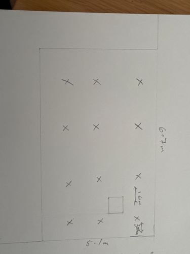

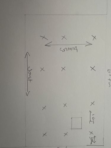

never built or done any decking just doing home working on deck framing/footing and stuff sketched up something in photos for footing end up being 1.6m apart is this info correct or do I just leave it up to the pros 🤣🤣 wanting to buy materials least maybe get someone to construct it
any help would be much appreciated
