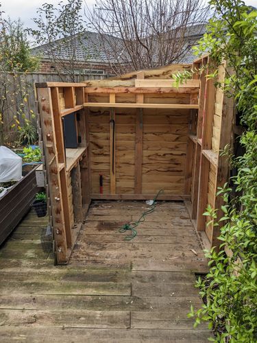

Re: Floor for cubby house
Yeh rubber mats should be ok to.
Not sure how solid they would be to hold the cubby house walls from moving around a bit
Good Morning @PatDIY_Dad
I was looking at the cubby house earler and have ben mulling over some ideas,
I thought maybe
Blue tongue particle board
It can handle being wet for a short time (3 months) and I thought if you put down that rubber matting then it would be a lot more waterproof. It would also secure the walls and make it easier to prop it up off the ground so air can circulate and not rot the timber. What is the roof made out of?
Hi
MDF (particle board) wouldnt last long at all out there?
Roof is colourbond sheet
Welcome to the Bunnings Workshop community @PatDIY_Dad. It's sensational to have you join us, and many thanks for your question about constructing a base for a cubby house.
It's wonderful to see two of our experienced members offer some great guidance.
What about treated Pine sleepers for the base? They'd be perfect for screwing the walls into because they are nice and solid. You'd then need to cover them with rubber mats to prevent the kids from coming in contact with the sleeper treatment.
If this structure has an enclosed roof, the particleboard will last for a significant amount of time. But, if it gets regular moisture exposure, it's perhaps not the best choice of flooring materials.
@PatDIY_Dad
MDF would fail fast I would say. I generally try and keep away from it wherever I can and definently wouldnt be using it outside. The blue tongue is supposed to hold up. I wouldnt have it on the ground directly but put some timber or bricks to give air space to keep it dry. I was thinking more that the covering would keep the water off the board. I just had a second thought. What about laying your hands on some of the concrete board (tip shops usually have some) that should last longer yet again.
Nice roof :smile: It seems to be a solid cubby house. Do you have a pic where you are going to place it?
Thanks MitchellMc
Yeh I am good with either .
Because I am "moving it" I would see the quality of the sleepers holding the crappy fence palings ( floor ) that the previous owners used to make the floor. If its still good Ill use that and maybe put some decking. The floor would also be a perimeter ( kind of like a porch) around the cubby house so half of it would be fully exposed to weather
