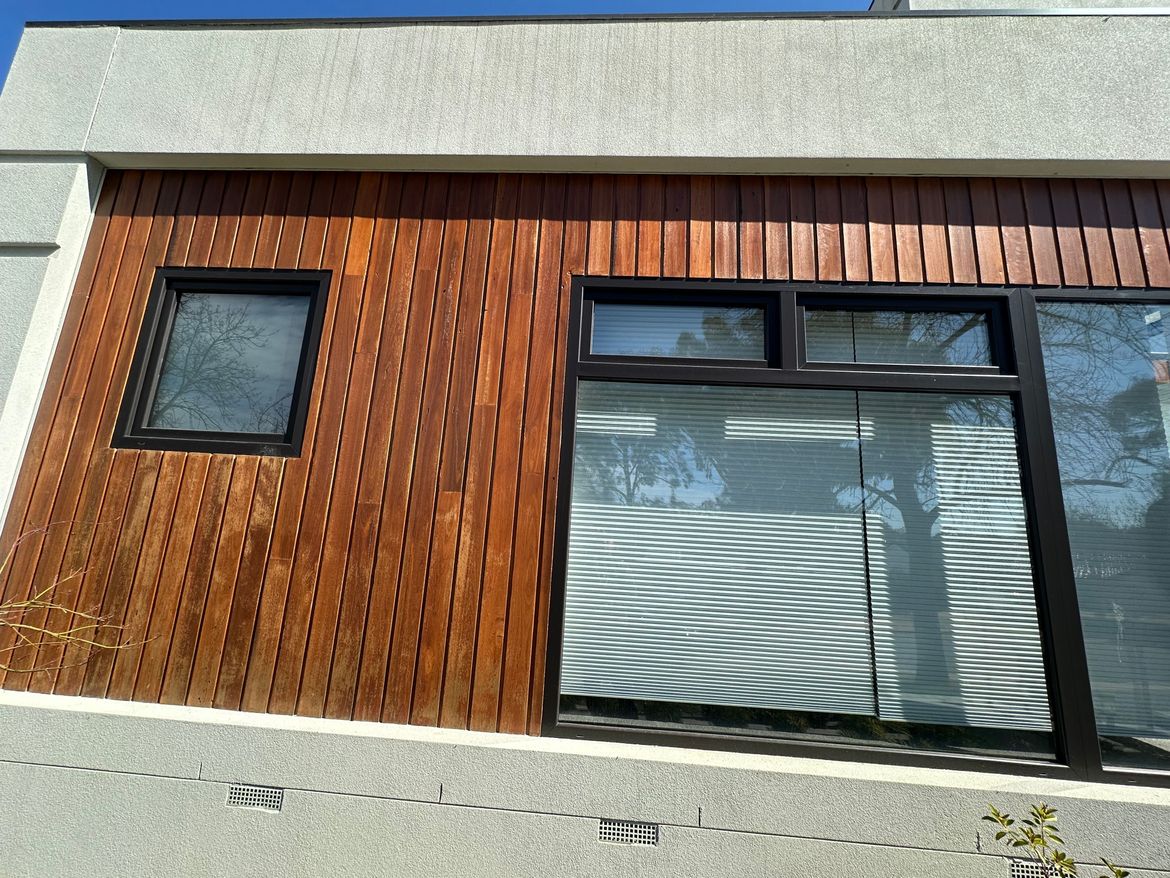

I moved into this place a little more than 2 yrs ago.
I can see the stain fading away on the cladding due to direct exposure to rain and sunlight.
What is the process to clean and oil the cladding as part of regular maintenance?

Hi Mitesh (@MSD),
Thank you for your question about cleaning and maintenance of your timber cladding.
You would treat the cladding in the same manner as you would a deck. Check out How To Oil Your Deck for some guidance.
Start by giving the timber a clean with a pressure washer. You can then scrub the timber with Cabot's Deck Clean and a stiff-bristled brush such as this Oates Long Handle Deck Scrub Brush.
Finally, flush the timber with clean water to remove any soap suds or leftover dirt particles.
You would then oil the cladding as you would a deck, using an applicator such as this Cabot's Decking Oil Applicator. Applying thin coats will help reduce any drips or running oil. Make sure you use drop sheets to prevent oil dripping on your rendered wall and windows.
Let me know what you think, and if you have further questions, please don't hesitate to ask.

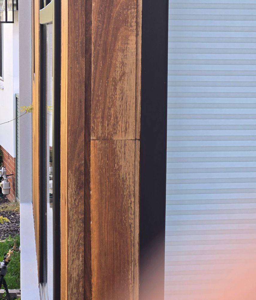

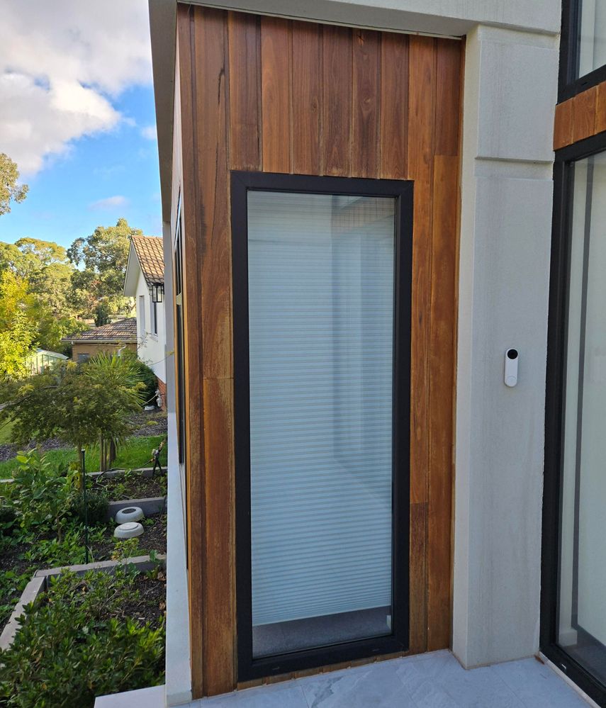

I have attached a few additional pictures. I the pictures you will see the timber on the side has weathered a little more than the other side.
I did run my hand over the timber and I feel it needs a bit of sanding, as the surface is not smooth.
Can you please advise what I need to do for sanding and what sanding equipment is required.1000119298.jpg1000119281.jpg1000119282.jpg1000119297.jpg1000119299.jpg

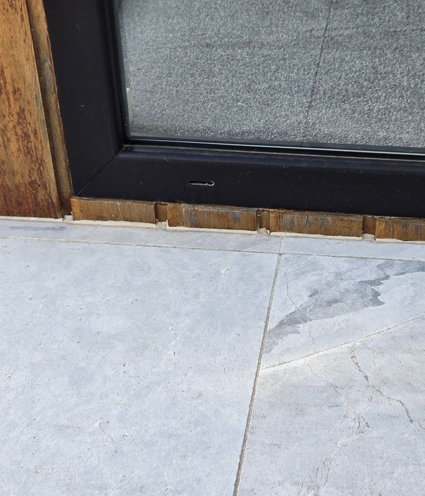

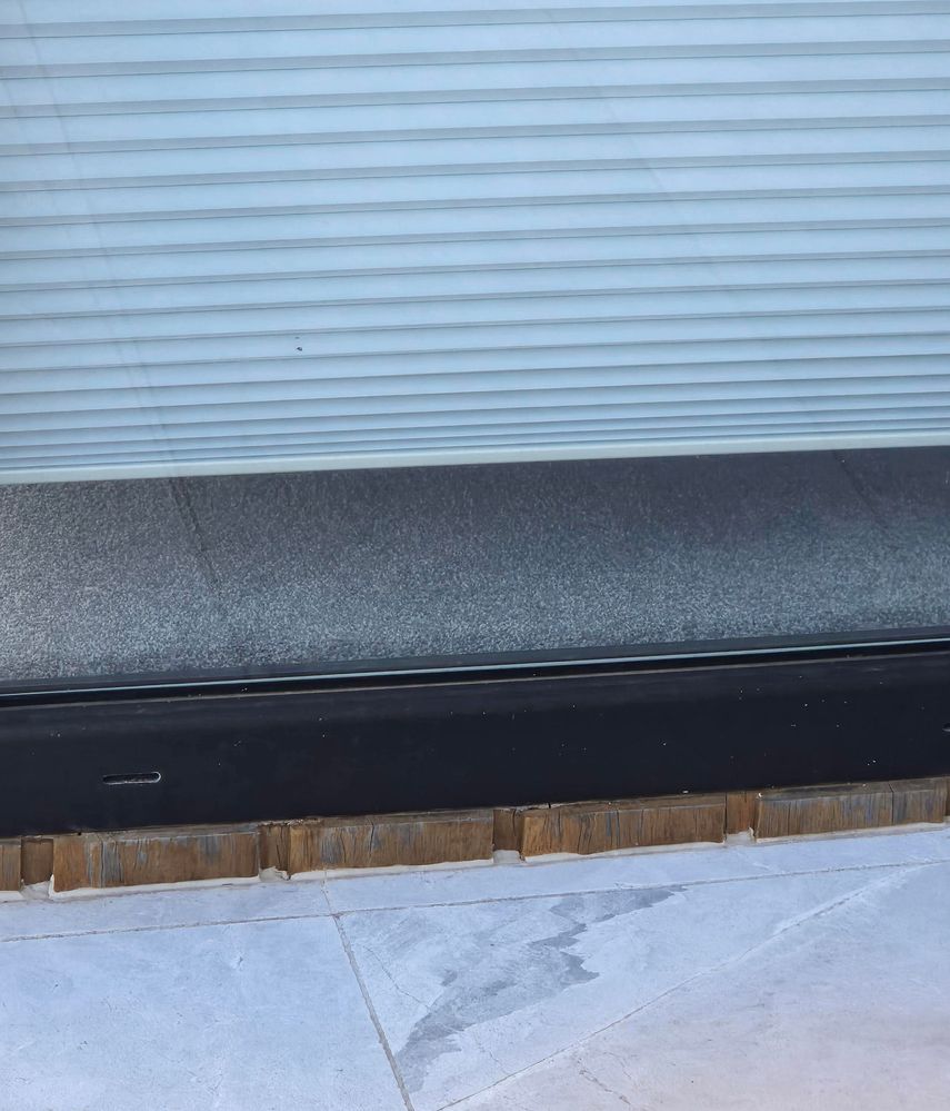

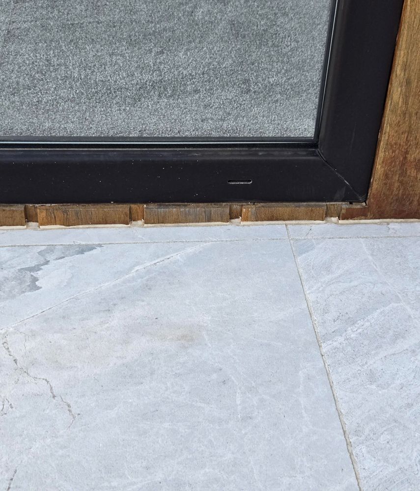

Also please check if what I see at the bottom of the window looks like mould?

You can sand everything cheaply by using 120 Grit Sandpaper wrapped around a Cork Sanding Block, however this will be time consuming and hard on your body.
To make the job easier, you can use a random orbital sander with 120 grit sandpaper to speed up the process and lighten the load on your body.
The timber at the bottom does not look mouldy; rather it looks more weathered than the rest, likely because it sits at ground level and water has pooled against it.
