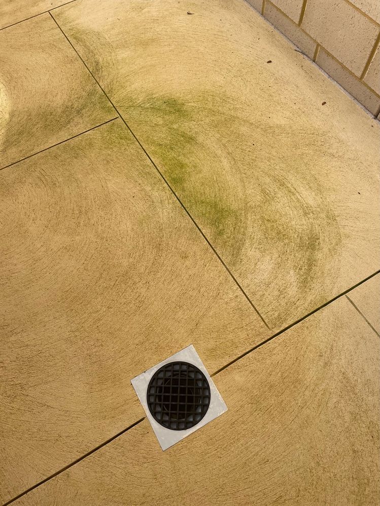

how to clean poured limestone path eg detergent type and power washer pressure.

Before I make any recommendations, would it be possible for you to post a few photos of your limestone path? This will give our members a chance to assess its condition. We can then make suggestions on how to clean it.
Limestone has a very porous surface and when cleaned too vigorously could damage its surface or leave it open to even more dirt and debris. I often recommend sealing limestone with Crommelin 15L Limestone And Sandstone Sealer once it has been properly cleaned.

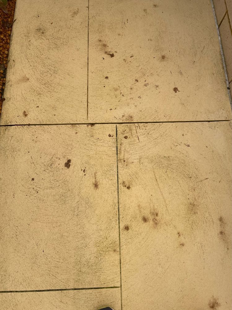

Hi @johnmisk2021
Thank you for posting those photos of your limestone path. I suggest using 30 Seconds 5L Outdoor Cleaner Concentrate in combination with an Oates Long Handle Deck Scrub Brush or similar. I recommend using only your garden hose to wash off the path as a power washer will damage the surface of the limestone.
Once the path is clean and totally dry, I recommend sealing it with Crommelin 15L Limestone And Sandstone Sealer
Re: How to clean poured limestone path?
Hi EricL, Thank you for your advice. 30 seconds  proved great for removing algae, coverage was as per label. Now to sealing as recommended. Thanks again.
