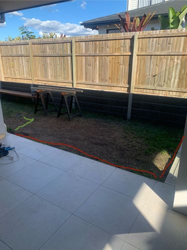

I’d like to install a drainage channel in an L shape alongside my alfresco (shown in red). The water will flow from the top of the picture to the bottom, then to the left where I’ll run a pipe to the existing stormwater pit in the middle of the yard (shown in green).

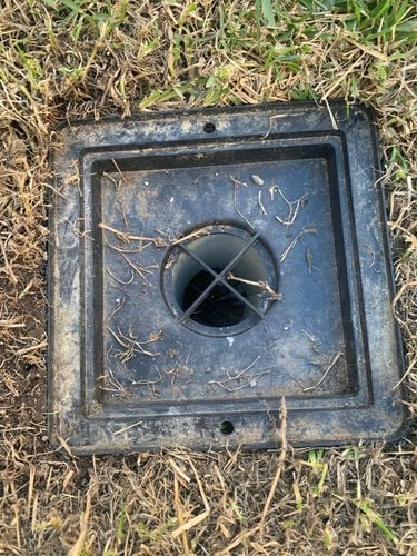

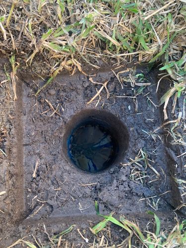

The pit is a shallow Everhard Flo-Way pit which has a pipe connected to the bottom that discharges into a stormwater system which is separate from the stormwater connected to the house’s downpipes.
What would be the best way to connect the pipe from the channel to the pit? So far I’ve come up with either replacing the pipe connected to the Flo-Way with a junction and then connecting the channel pipe to the junction, or replacing the Flo-Way with a deeper rainwater pit and connect to that. Would either of these options work or is there a better way?
