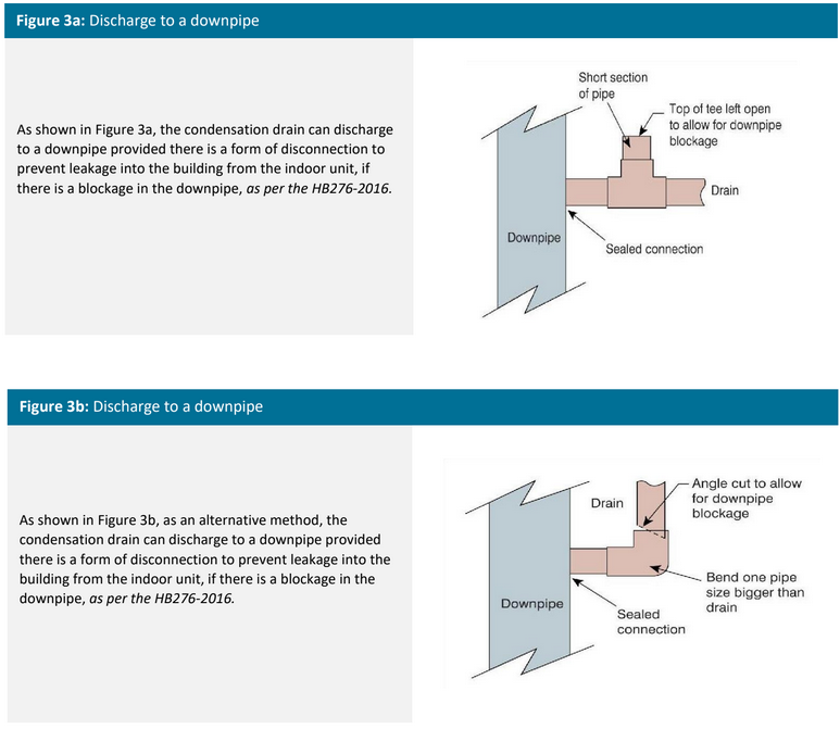

I am looking at connecting my A/C drain to my closest downpipe to avoid it discharging next to the house and potentially making its way down to the foundations.
What connection would be recommended where is calls for a 'sealed connection' below.
Would drilling through the downpipe and sealing the pipe with some silicon be sufficient or should a use some sort of saddle?

Welcome to the Bunnings Workshop community @falconed. It's great to have you join us, and many thanks for your question about connecting an air con drain hose.
I'd suggest using these part to create Figure 3a: Holman 20mm x 1m PVC Pressure Pipe, Holman 20mm PVC Plain Tee and a Holman 20mm 90° White PVC Elbow. Arrange them as I have shown in the rendering below. Your drain hose is placed within the 90-degree elbow at the end. The fittings can be glued together with PVC cement, which can also be used to glue the adaptor into a PVC downpipe. You'll need a 20mm spade bit to drill the hole in the downpipe.
