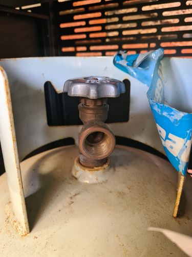

I'm having difficulty connecting my Pitboss Ultimate Griddle to a gas bottle.
Is there a particular bottle type that I need as it's not screwing on.

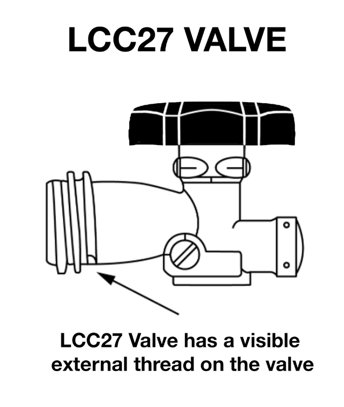

Most current BBQs now come with a hose that is compatible with the updated LCC27 gas bottles. Your gas bottle is of the older style, which is being phased out. If you take that gas bottle to your local Bunnings, you'll be able to swap it over at the cost of a refill and pick up a newer style bottle which is compatible with your BBQ.
