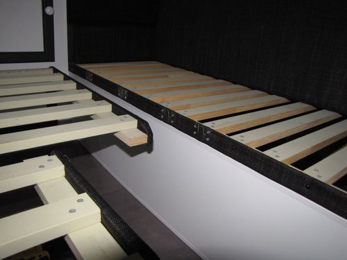

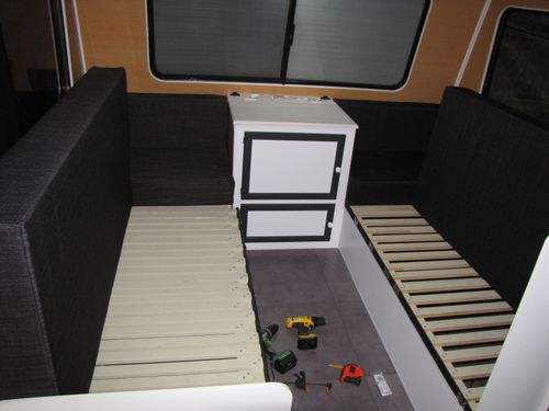

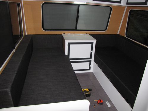

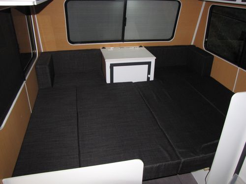

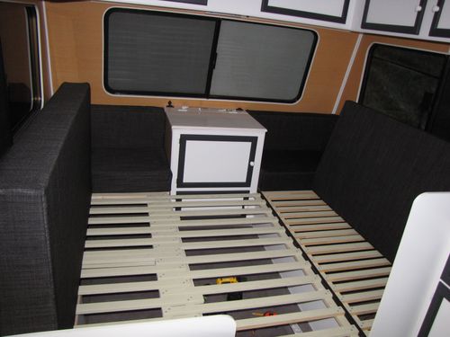

Are you looking at a temporary or permanent conversion? In my first reno, I built 2 single beds with a slide out section to convert them to a double as required. There are some great instructions on this website to make the slide out section http://deepredmotorhome.com/bed.php
2 single beds
both sides hinged to access storage underneath
one side slides across to the other with furniture connectors to hold instead of free standing like in instructions
2 sections to make it easier to slide
backing cushions drop to create full east west double bed. Top of cupboard hinged to continue access.
