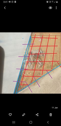

That slab was reenforced with steel approx 50mm thick concrete pad floating in loose sand which is ok for paths but next to a drive way well trucks or cars could be hitting it and will do that damage. I would want to lower that pipe level with drive way if possible or slope cement up to it I would want to fill that whole triangle with min 100mm concrete with drilled in reo ( Purple) to surrounding concrete so slabs always stay level together,
The triangle slab sounds hard but not really a ozito rotary hammer drill will quickly make side holes for reo(purple lines) and just level concrete to cement edges . Cant hurt to add foam expansion joint along egdes poke the reo through it into concrete. (Blue line ) Add more reo mesh (red) Brown 100mm min outer cement formwork. On a construction site we would cemset (glue ) the reo into the drive way but I use friction fit domestic (tap them gently in to concrete surrounds)

New slab
David I suspect any low cover over it would be run over eventually by some ones car . a taller column would be easier to see when reversing but also hit by car on occasions one in 4 years? As it is close to drive way.
