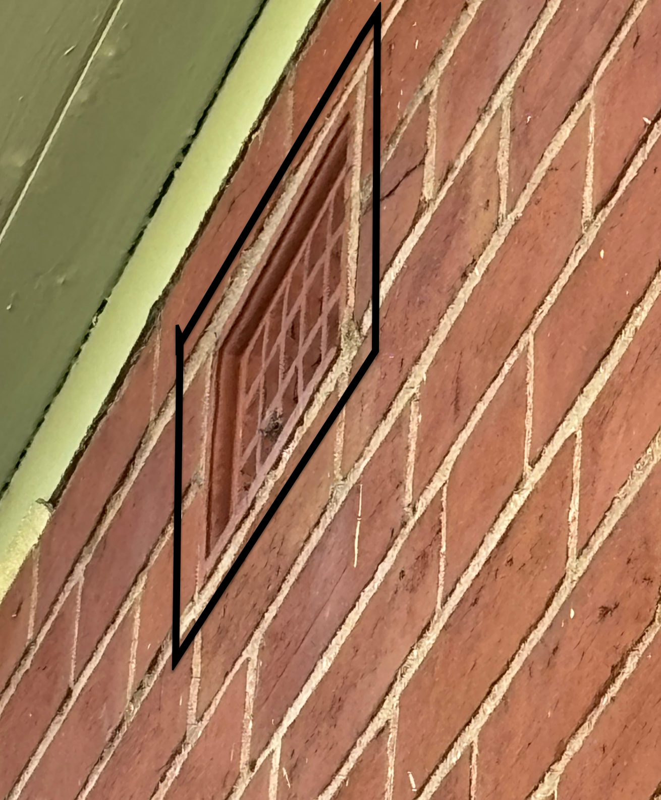

Hello I need to stop bees going into the external vents on a federation house. Looking at fry screen mesh to keep air flow but how do I attach it? What do I use?  I have 16 vents to cover.

Do you have access to the inside of the vent?
While it is certainly possible to block it from the outside, I just thought it might be a bit easier from the inside and it is worth checking.
If not, then I would suggest running your flyscreen over the vent and slightly out on to the surrounding bricks. See below for an approximate location.
I'd suggest going this wide, so you can attach the flyscreen to the bricks, rather than the mortar, which won't give a strong hold.
You can use masonry plugs to screw a timber frame, made from 42 x 11mm H3 Treated Pine, over the flyscreen to lock it in place. A couple of staples into the mortar will hold the flyscreen in place until you can screw the timber over the top to lock it in place.
