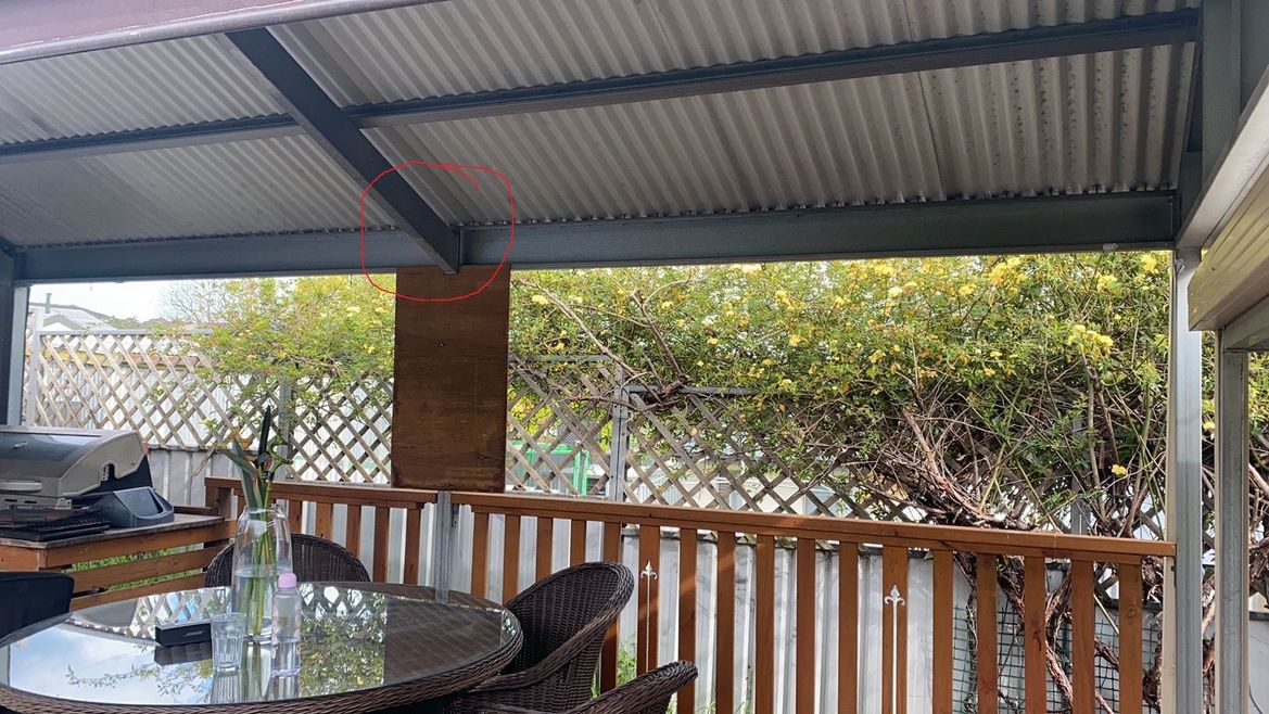

Hello,
I have a patio area that I would like to make some changes to for more privacy. In the photos you can see that the side is wide open to passersby and neighbours. I am wondering if maybe fixing something like shade cloth there would be a good idea, or if there are better solutions? As can be seen in the photo, the top is metal as is the post on the right side but can be drilled into (also, please see photo for measurements). I'm open to any suggestions, thank you.

Thank you Mitchell for your welcome and reply, very good information and nice to hear you have used those yourself with good results. Apologies I have been slow to get back to you by the way. The roll-up blinds you linked look great, though I think there may be a hitch in putting two of them side-by-side because of that beam that runs down on an angle which it seems would get in the way of that plan (circled in photo attached). That being said, I think those roll-down blinds would be good for other areas of my property. Though I am wondering if there is a way to fasten those blinds at the bottom for times when they are rolled down but it's very windy? Would not like them to rattle or bang around on very windy days.

It's great that you've received excellent advice from my colleague @MitchellMc. One way around the gap issue is to install a long timber panel along the length of the patio frame. This can then be the point of installation for the roll-up blinds. To keep the bottoms in place, I suggest using Carabiners in conjunction with GRUNT Galvanised D Ring Anchor Points or similar.

To get around the beam issue, you can screw a length of 42 x 31mm 5.4m Baluster H3 Pink Pine FJ Primed EBR3 LOSP to the underside of the frame. This length of timber will then give you an unobstructed verticle surface to mount the blind onto. I've created the rendering below for you to better illustrate.
The blind will come with bottom mount brackets used to fix it in position and stop it from flapping around in the wind.
