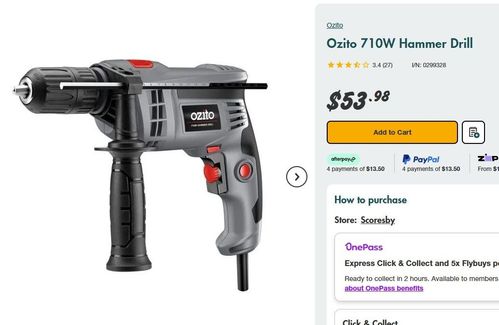

I do lots of DIY and never use any of my cordless drills that have the hammer mode thing.
Ozito 710W Hammer Drill (good value) along with the Kango masonry drill bit set 👍
When drilling rather than continuous pressure I use a plunge action which not only clears the hole but more importantly helps to keep the drill bit at a lower temperature.
Cheers
Re: How to drill into concrete and brick?
Hi @diy_dude,
Just to add some backing to @AlanM52's comment, I also own this Ozito 710W Hammer Drill. It is perfectly suited to this work and fantastic for the price.
Definitely worth considering.
