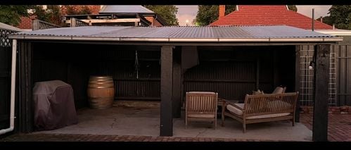

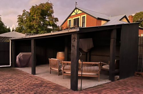

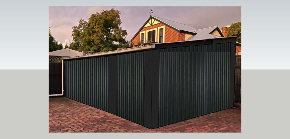

We have this outdoor area that seems to be an old stable or something similar. We would like to convert it into a garage/shed for storage as it will allow us to demolish another besser brick storage that currently takes up a big chunk of the backyard.
All we really need to do is enclose it in a cosmetically appealing and functional way ![]()

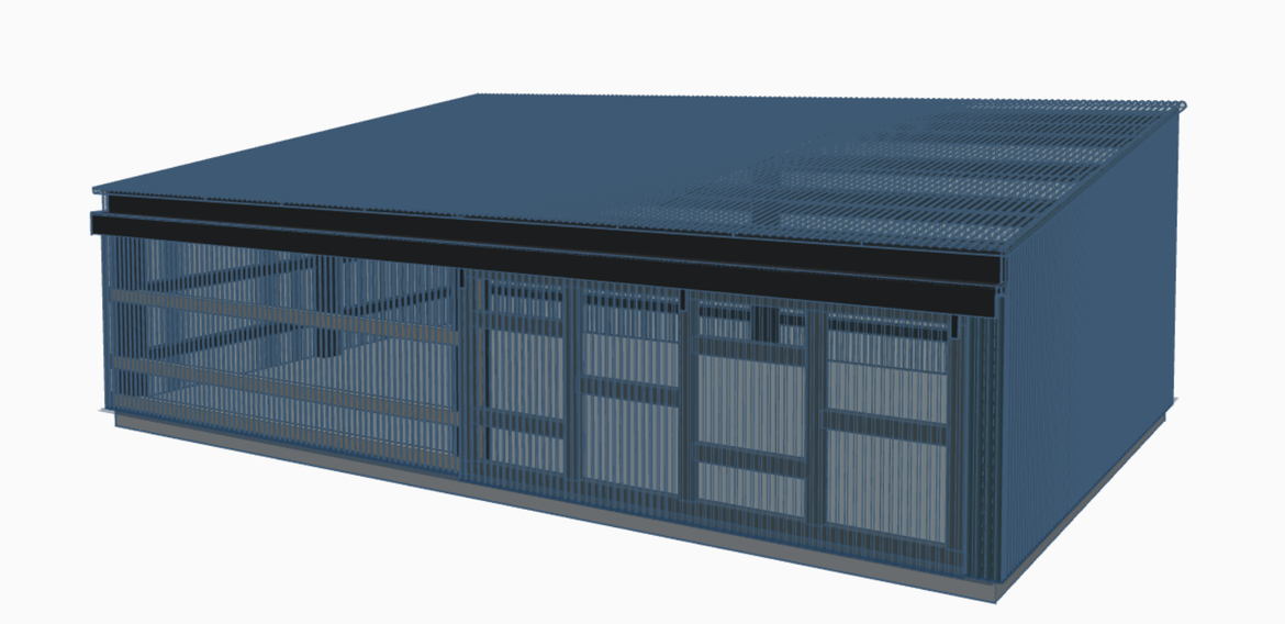

First and second photos are our place. Third is the inspiration

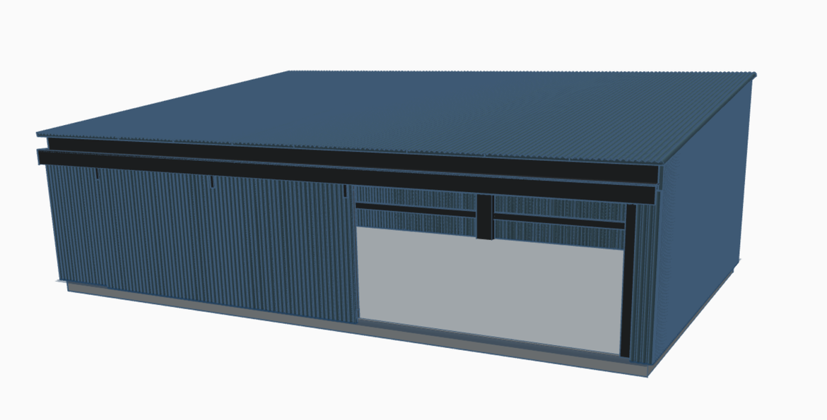

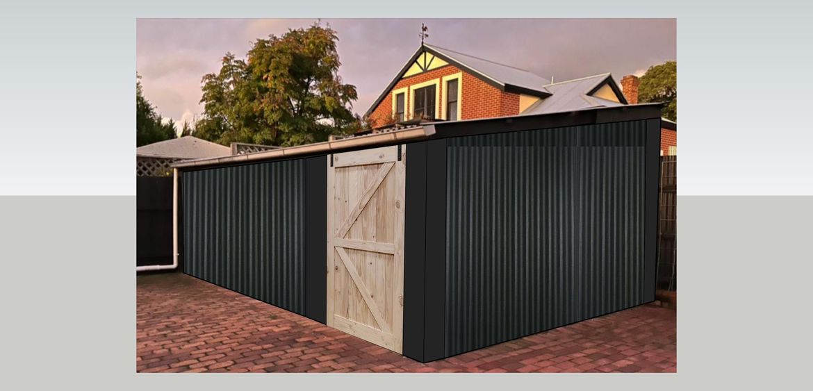

It's great that you've received excellent advice from @MitchellMc. Just to add some visual ideas for your barn cover, I've drawn up some examples of how it might look with the corrugated sheets and with a barn door. Please have a look and tell me what you think.

Thanks Eric. This first picture is actually exactly what I had in mind! Only difference being that I will need an access point to get out the items/gardening materials (mower etc) stored in the barn. That is what I thought the sliding door could be useful for.
That said, I am looking for the most cost effective option and so am open to thoughts.

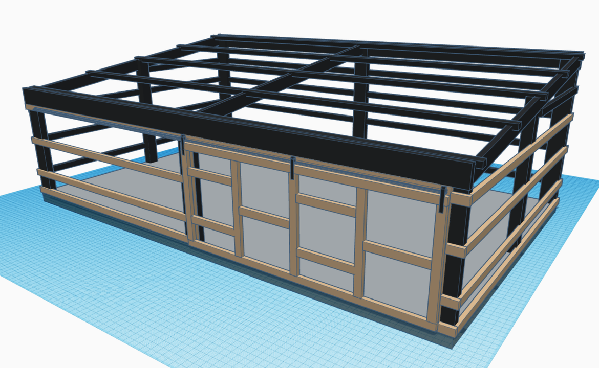

@MitchellMc I love the visual that you have provided too. are you suggesting to use timber for the red lines, and to use a piece of timber across the middle and bottom to tech screw the sheet into (green lines)?
I think that part is relatively straight forward. I like the suggestion of removing the existing sheet too. The challenge for me will be putting the door together.

Your analysis of @MitchellsMc's drawing is correct, but the green lines I suspect represent the outline of the galvanized sheets. Would it be possible for you to post the dimensions of the barn you are trying to cover? Our members can then assess its layout. We can then make recommendations on how to cover it.
Yes, I am @amateur63, as that appears to be how the shed was initially created. The sheeting (green outline) is screwed to the three horizontal timber batons (red lines) and the roof beam. You can see where someone has cut the batons back and removed some sheets.

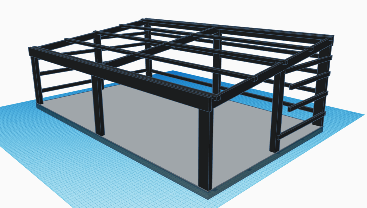

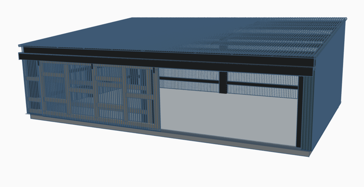

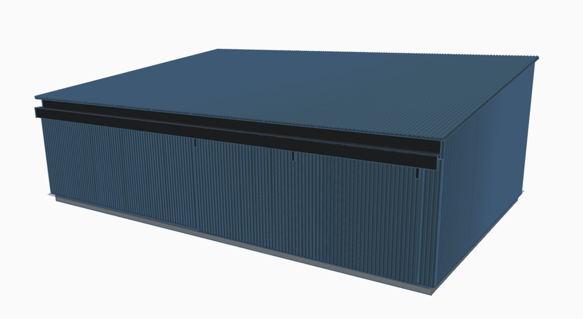

Hi @amateur63,
I've spent some time and put several renderings together for you, hopefully giving you a better understanding of what will be needed for your project. Have a look at them and let me know if you have any questions.
