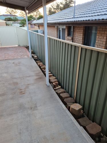

Hi Mitchell, cheers for the helpful response!

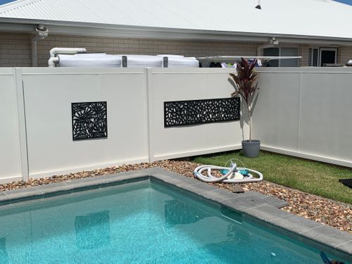

Images below - as you can see, the neighbours dog has waged blitzkrieg on the fence and the fence position doesn't do much to block sound coming into my carport. I was originally planning on just painting the colorbond, but I now want to achieve a similar outcome to @ProjectPete & @Cracks (inspiration picture attached) - I will paint the concrete driveway, add gravel with agi pipe to level out the gap (after building up with sleepers), and will add some juniper or cypress in pots.
We will add more concrete to the posts of the colorbond, though the fence has stayed remarkably straight as is.
It sounds like timber framing will be the go to - I will encourage my neighbour to clad his side of the fence in the same way for symmetry and strength. I don't mind if he doesn't pursue that option, but I told him that the new extension will look ugly if he leaves it as is. He's sympathetic to my cause for wanting the extension!
I am undecided if I want to add the wooden trim over the posts, or if I will attempt to use joint compound to smoothen where the sheets butt on.
Regarding the frame, there will be many gaps between the frame and the colorbond posts due to the C channel
profile. Is this ok? Should I pack it out somehow?

Now that I've seen photos of your fence, I propose having a look at this discussion as a possible alternative - Merbau panel screening by @WendyL. It's a great way to add extra height to your fence and at the same time covering the Colorbond fence.

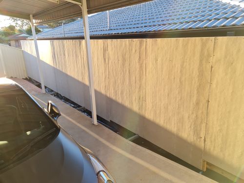

stage 1 complete! Sleepers inserted, and instead of additional concrete we fabricated a galvanised shs tube to brace between the posts and bolted into the concrete. Took me and my neighbour all day!
I will be building the frame next. 35x70 treated pine, trying to keep the slimmest profile possible (unlike say framing a house where you turn the longer side of the lumber perpendicular to the wall, or unlike a post and batten system). I'll likely use pocket hole screws and glue unless someone can convince me otherwise
My question is - how should I attach 4.5mm Hardie tex to the frame? The brochure recommends hammering in nails, but I'd prefer to avoid that. I do own a brad nailer, but unsure if the heads are large enough to hold the sheet properly.
If I use counter sunk self drilling metal screws, is there a trick to it? Is there a jointing compound where can smooth the screw heads, like with gyprock?

Pocket holes screws and glue would be fine, or you can just screw through the butt joints with Climacoat screws.
Hardietex does need to be nailed to a timber frame. You can hire a framing nail gun for 4 or 24hrs for a reasonable rate. Brad nails do not have big enough heads to effectively hold the sheets.
You can use a patching compound like Polyfilla 500g Exterior Brick and Render Masonry to fill over the heads of the screws.

and she's up!
Very happy with the neatness of the look.

That fence cover looks fantastic! In regards to Taubmans Sunproof, there is no need for a primer as Sunproof is self-priming. Just make sure that the surface is free of dirt and debris before you start painting. I also recommend covering the floor with paint cover sheets so that any errant paint splashes will not go on your driveway.
For the fence capping, I suggest either 90 x 22mm Decking H3 Treated Pine - 2.4m or having a custom Lysaght flashing ordered at the store. I suggest speaking to your store's special orders team in order to get a quote for the custom flashing. Please make sure to provide yourself with a bit of leeway when ordering the custom flashing as it will be machine processed. This means that when you ask for a 55mm channel it will be exact and will have no room for play or adhesive.
