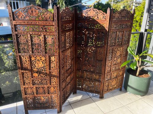

I have these two timber privacy screens. They are both lovely, and so I don’t want to get rid of them - but neither is currently tall enough by about 20-30 cm.
Is there any easy way to add height to the bottom of the screens?

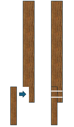

My first thought would be to graft on new sections of timber to extend the legs as per the image below. Dowels can be used to strengthen the joint. Concertina screens are already not particularly rigid, so extending their height would only add to their instability.

You say "two screens" Are there two seperate screens with 2 panels to a screen? The reason i ask is if we extend the base (or top) legs with another piece of timber on the side, the folding action may become jammed when the hinges are laid flat. At the moment when you flat pack it all they will sit, if I went with extending the legs by screwing something to the side then the hinges will catch the extended piece of timber potentially. @MitchellMc's way would stop that happening but also would be a weaker point.
If the panels are only 2 wide then you can extend it on the none close edge without a worry (other then astheticly) Will wait and see how many panels are on the screen.

They are so decorative that they would definietly need to be raised from the bottom, which @MitchellMc has provided a great solution.
Another possible one would be to cut out a notch in the bottom of the legs and use dark stained DAR pine to extend them. These would be glued and fasted screws or nuts and bolts.
