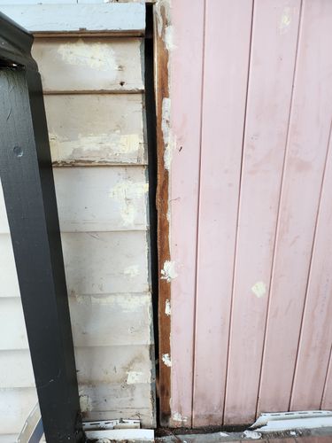

Have an old home with plastic cladding that has deteriorated and sustained some storm damage. Starting with the front porch, removed it and found this. Pink....very interesting.
Have started removing the nails and filling them with outdoor wood filler. Plan is to paint white and add new window architraves. Add balustrade and retile

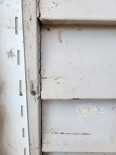

Just wanting to know what I should use to fill the cracks between the vertical and the horizontal hardwood weatherboard? Wood filler or silicone? Or something else.
Then what can I do to bridge this gap between the horizontal and vertical. And as you can see, nothing is square in an old house

Hello @AnitaP
I suggest using Sika 310ml White Sikaflex Pro+ Polyurethane Sealant on the weatherboard so that it does not crack or split. As for the giant gap I propose filling the gap with Parfix 340g Expanding Foam Filler and covering the gap with a timber trim such as 66 x 18mm 5.4m Moulding H3 Treated Pine FJ Primed Half Splayed 2 LOSP. The remaining gaps on the weatherboard and timber trim can be covered with the Sikaflex sealant.

Hi @AnitaP
My suggestions are along the same line as with @EricL. I had to replace quite a few weatherboards at a medical clinic the other week and this is what I used.
For the weatherboard ends scrape away loose or flakey paint. Clean the area with a damp cloth and allow to dry. I use this filler which isn't fast drying so will allow you plenty of time to smooth it over and is water based.
I would use this timber trim to cover the vertical section and use the gap filler down each edge. But if the vertical gap is wider, then go with the trim @EricL suggested.
Also prime coat paint the ends of each piece of timber to extend life.

Thanks @EricL . I was thinking expanding foam, so I'm on the right track. Thank you for your suggestions
Re: How to fill exterior wall gaps?
Thank you for your suggestions. I do like something that isn't fast drying. I'm not the best with using a sealer
