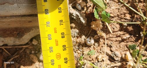

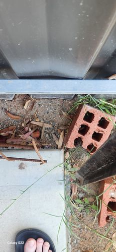

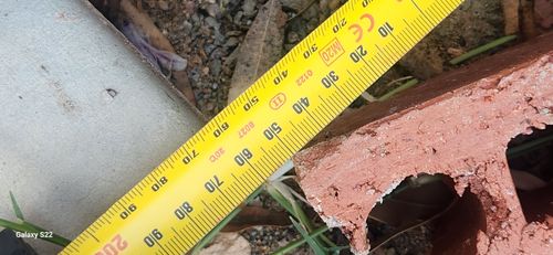

hi im wondering how can close the small gap at the start of the concrete pathway an fence so i can put little rocks along the fence so the rocks don't fall out .
Hello @Chris8411
Welcome to the Bunnings Workshop community. It's sensational to have you join us and thanks for sharing your question about filling the gap between your concrete path and the fence.
I suggest installing Tuscan Path 75 x 3mm x 20m Black Thinline Eco-Edging on the edge of the concrete path and on bottom edge of your metal fence. I propose not imbedding the garden edging too deeply so that it keeps the pebbles inside the gap. I also recommend putting geotextile at the bottom of the gap to prevent weeds from growing in between your pebbles. The garden edging can be cut or bent using a heat gun to form a closed end to prevent the pebbles from flowing out.
