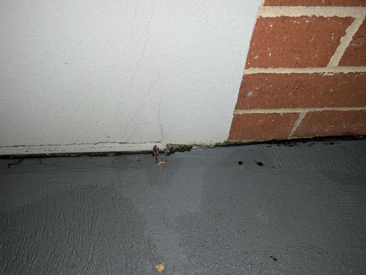

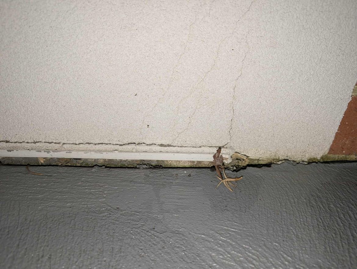

I have a house with concrete sidewalk around the house. However, there is this gap between the sidewalk and foundation as shown in the pictures (I hope the pictures are clear).
I am after advice on whether this is a problem and also what are the steps to fill this gap.

I probarlly wouldnt worry about that size of gap too much, houses and paths do expand and move a little during the course of a year so you may notice more sometimes then others. If it is worrying you, then you could use something like Sika 310ml Grey Concrete Sikaflex Pro+ Polyurethane Sealant (comes in different colours) to seal the join with a bit of flexibility.

It's great that you've received excellent advice from @Dave-1. Just to add to the suggestions made, if the gap between the wall and walkway are around 5mm or greater, I recommend inserting Moroday 6mm x 5m White Gap Filler Rod or bigger if the gap is much wider. Push the filler rod around 5mm deep into the gap, this will prevent the Sikaflex from sinking in too deep into the gap and flowing away.
