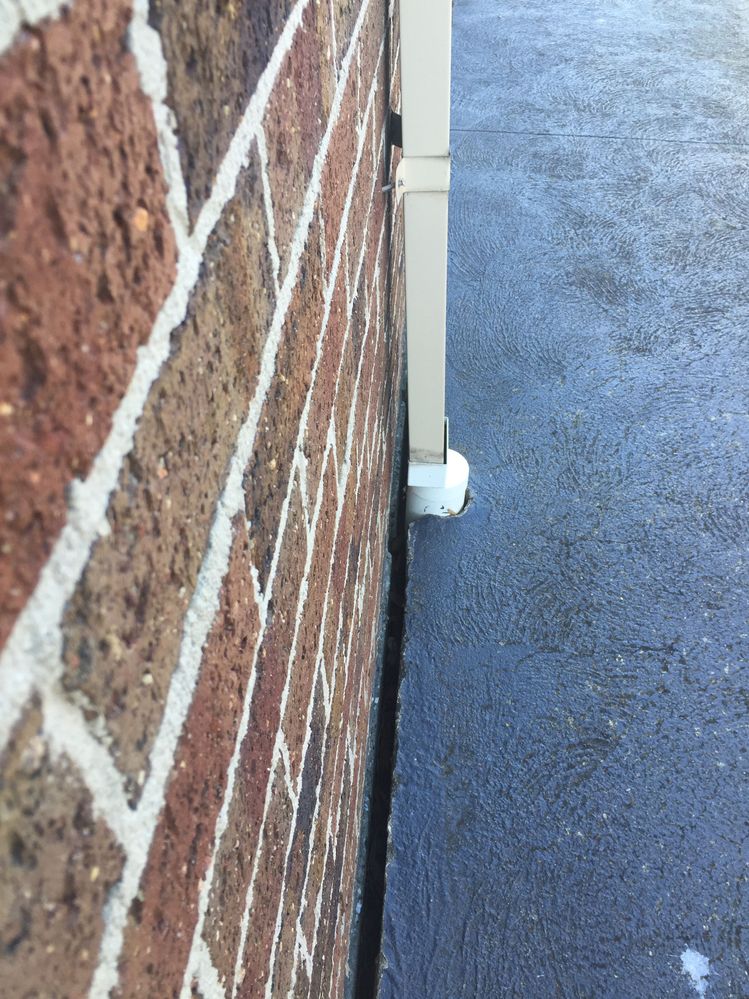

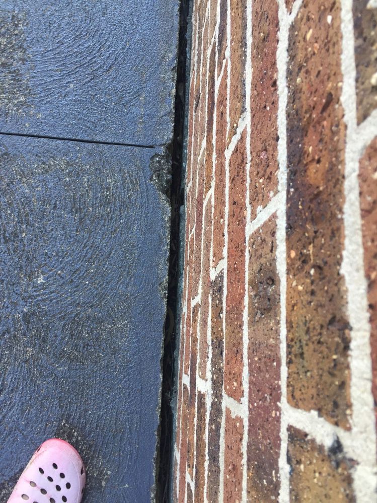

I am noticing a gap between external wall and concrete floor, has increased from a centimetre to about an inch in last 12 months, rain water sneak in, insects crawling, pl suggest as how to fix.

Hello @Rohitash
Thank you for posting those photos of your concrete walkway and your wall. Let me tag my team-mate @JacobZ to make him aware of the photos. Unfortunately, I'm afraid the gap is now too big to be repaired with Sikaflex. Although some parts might be able to be covered up the large portions are just too big.
I believe rainwater has entered through the gap or elsewhere and has run under the slab causing it to sink and move away from the wall. This water ingress must be addressed first as any repairs carried out will prove useless.
It might be possible to fill the gap with new concrete, however, that means that the slab will remain on a slant. Plus, there is no guarantee that the slab will remain stable with this type of fix.
I'm currently not aware of a D.I.Y product that can uniformly lift the slab back into place. I suggest engaging the services of a concrete slab repair specialist, The specialists will be able to lift the slab using polyurethane or a similar product.
