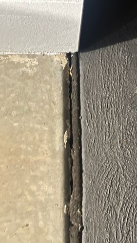

how shall I fill the gap as shown in the image?What material and steps shall i follow?

I suggest cleaning the gap as much as possible and removing any loose debris that might be in the gap. I recommend using Sika 300ml Concrete Grey Sikaflex 11FC Purform on the condition that the gap is no bigger than 5mm. If the gap becomes bigger, I suggest using Moroday 6mm x 5m White Gap Filler Rod to prevent the Sikaflex from dropping into the gap.
