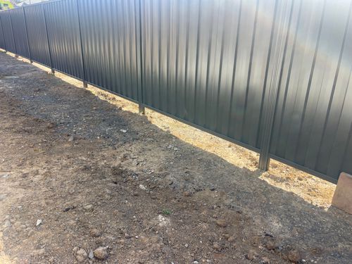

Hi all,
My fencing got a gap and needs to fill it. Can you please suggest some cost effective solutions. I have attached the photos for your reference.

Generally, I suggest using 200 x 50mm Sleeper H4 Sienna MicroPro 2.4m or similar. There is no need to take the fence apart simply dig a channel under the fence so that there is enough space for the sleeper to slot into. You also have the option of using concrete and composite sleepers. To keep the sleeper in place you can use Jack 450mm Heavy Duty Steel Sleeper Peg Flat Stake or the Jack 450mm Sleeper Peg Steel Corner Stake along with the Jack 450mm Sleeper Peg Steel Flat Stake. Once the pegs are driven into place you can then screw the supports into the sleeper.
