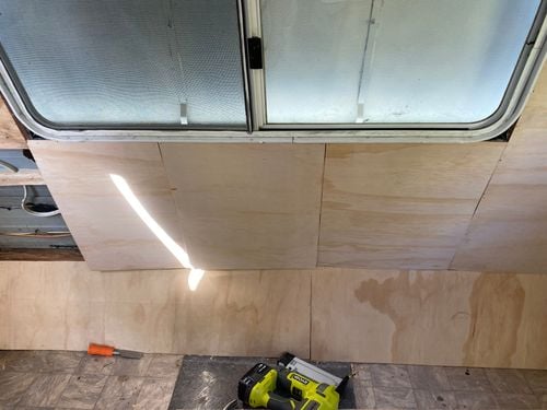

Hi team, it’s been awhile since I posted. I am seeking suggestions on how to fill gaps between plywood. Now I am no expert on ruling a straight line or cutting lol, hence the gaps. Don’t worry about the corners. They have been sorted. I haven’t fully nailed the ply in as yet.
Also looking at painting once I am done. Thank you all
Hi @Peppers,
It's fantastic to see progress has been made on your caravan restoration.
Considering you are planning to paint afterwards, you can use a wide variety of filler products. I'd suggest something like this UNi-PRO Multi Purpose Interior Filler would be a good option.
You can apply it to the gaps using a joint knife, allow it to dry, then sand it and finish with primer, followed by paint.
