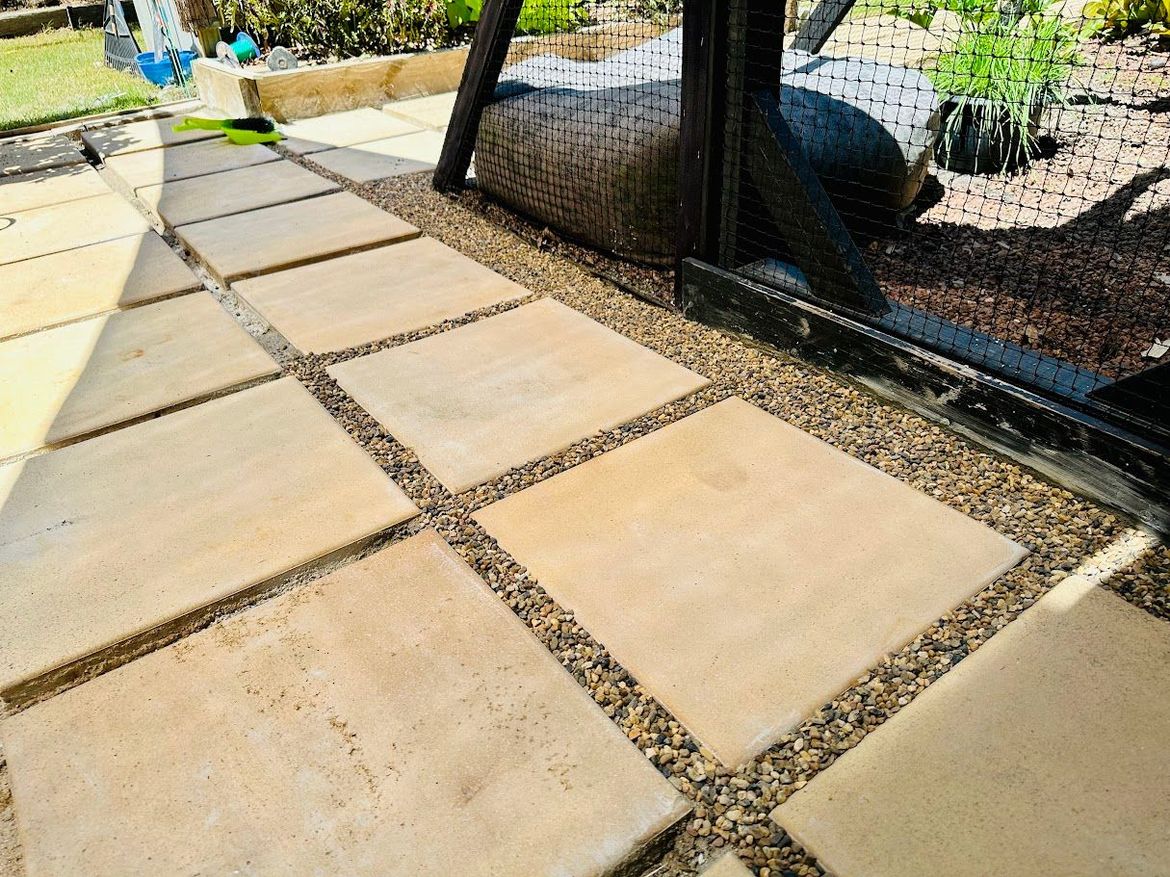

Hi Katie,
I've just put in some smaller pebbles Tuscan Path 4-6mm Natural Mixed between pavers. First adding a little more mortar mix into the space (as we originally had larger stones in between) to use less of the smaller pebbles - then laying them in after the mortar was dry we've tried out a newly found product Landscape Lock (which we're calling Rock Lock!) and so far we're loving it.
I don't have a cleaned and complete photo as yet, should be all done tomorrow and I'll update again. But the Landscape Lock is an absolute blessing, we've been walking over the pathway each day this week as we've completed parts and have had next to no movement in the pebbles, worth looking into if you do like the pebble/stone look but not the movement.
Good luck,
Chantel
Tuscan Path 4-6mm Pebbles with Landscape LockTuscan Path 4-6mm Pebbles with Landscape Lock

Your pavers look great and the fact you won't have to keep brushing the stones back into place must be a great relief.
Thank you for sharing your project and your experience with Landscape Lock.
