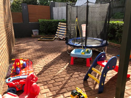

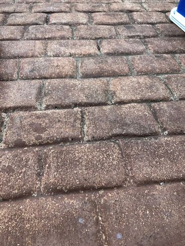

I’ve just moved into a new home and the back garden area has textured concrete brick effect.
I would like to level the area and put matting or Astro grass for the kids to use as a play area.
The voids are approx 10mm.
Any ideas what I could use to fill the voids and level the area? Any help appreciated.

You might like to do a test section to see if adding sand to the gaps would be sufficient. That would require the least amount of work, and the area could be restored if needed. It would be worth considering Dingo 20kg Powerloc Paving Sand as it includes a binder to stop the sand shifting. Alternatively, for a more permanent solution, you could cover the area with Lanko 20kg 173 Floor Leveller and coat it with paving and concrete paint. You'll need to check how level the area is, as when a slope is present, the Lanko product will self-level to adjust.
If you were to purchase a DIY Turf 1 x 1m 20mm Pile Grass Mat and Brunnings 20kg Landscape Paver Sand, it would give you a fairly good idea of whether the sand would suffice.
